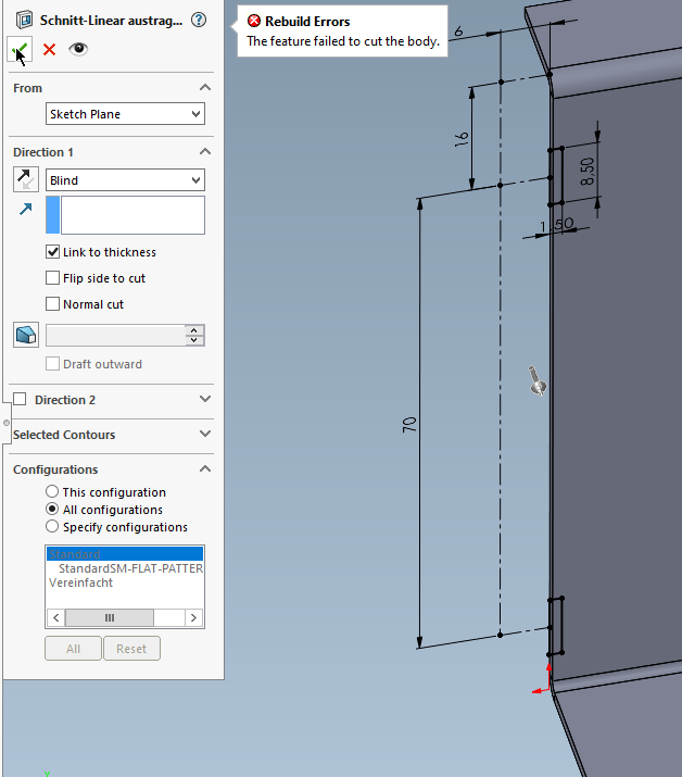

The feature failed to cut the body
I opened file and after CTRL+Q feature tree is red and yellow.
First error is with cut extrude option and it says “the feature cant cut the body” .
I cant add any new features because of same error.

Try flipping the direction. The arrow indicating cut direction is pointed away from the body.
… because in these terribly ambiguous situations that is the most helpful direction to cut.
Sketch is on the other side (face which is not visible)so direction is ok.
Anyhow it does not work in any direction no matter what depth i choose.
remove “link to thickness” and select “through all”.
Should fix your issue IMO
I tried , with all possible options.
I tried to recreate feature.
SW says NO

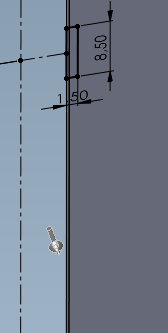

Are you sure the sketch is closed? As a test, try to extrude it.
I can vouch it’s closed. Sketch lines do not have the same thickness for open profiles. They become “as thick” as construction lines.
Yes , and i dont believe it would work on another PC if sketch is open

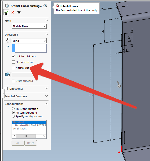

have you tried normal cut?
Yes.
Unfortunately it wont work.
