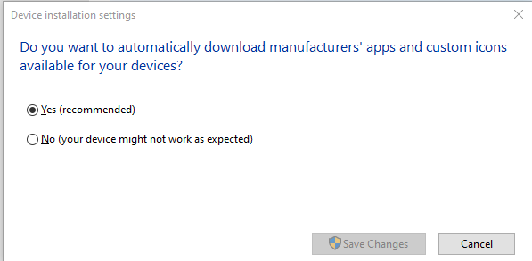

Open windows Settings and search for “Device Installation Setings.” When the window below appears, select “No.”
Yep, we considered this, but the idea of “all or nothing” seems extreme. And I don’t think IT was very cool with the idea , nor do I want to start having to manage every driver for the sake of dealing with specifically the graphics drivers…
In our case, updates are launched by the server and only the server, so once I get the designated drivers on our Workstations, the graphic drivers update is disabled on the server side.
