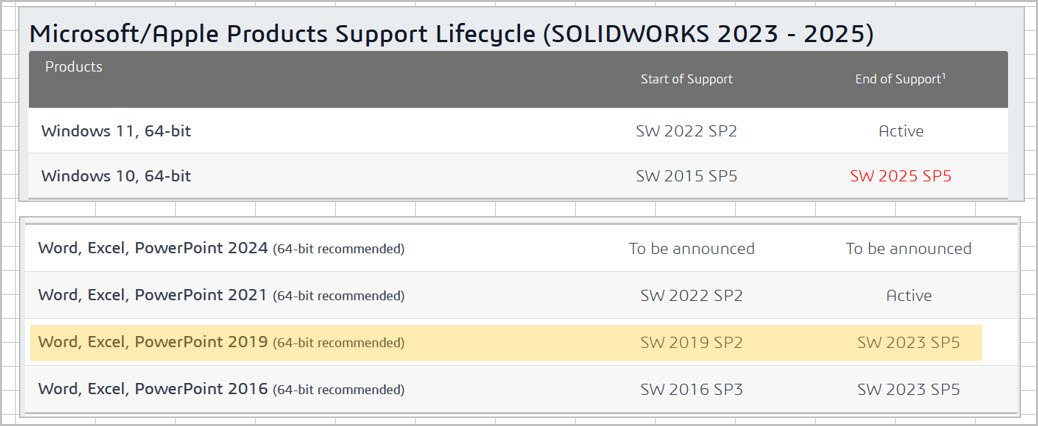

I’m currently running SW2024 on Win-10 along with MS-Office 2019 which obviously includes Excel 2019. On SW website link below it says end of support for Excel 2019 ends with v2023 SP5. Yikes, how time flies. I’m not detecting any anomalies with Excel but thus far has been confined to relatively simple design tables. Is there anything I should be concerned about? Another consideration is I’m just about to embark learning SW API. I (think I) realize this is more confined to within SW itself, but I get the impression some macros engage with Excel, so maybe Excel-2019 compatibility issues from that standpoint?

Forgot my screen grab created from link

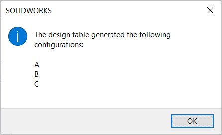

I’m on SW 2024 SP2 & Excel 2019. I just did a quick test. It ‘seems’ to behaving itself? As mentioned I haven’t done much in the way of more sophisticated Excel related applications but hopefully this is a good sign (pics). I also loaded an old file from v2020 era, it converted to 2024 & design tables appear ok.
