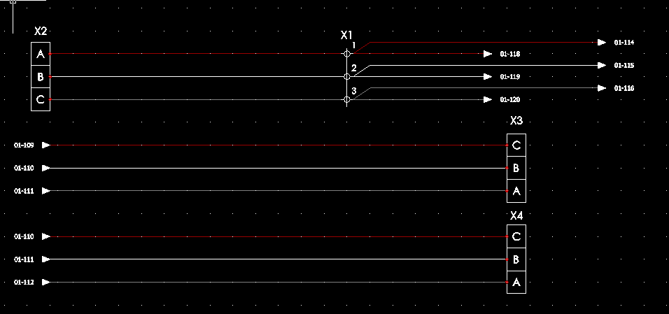

There is a built in design rule check named Origin destination arrow connected to different wire styles. This design rule check does not appear to do what it claims to do. I created this simple schematic:
It should pass the design rule check with no issues, but every origin-destination symbol ends up in the report:
Does anyone have a fix for this report or the SQL for a report that actually does what this one claims to do?
After further investigation, the different wire styles aren’t even the source of the bad behavior. I can change things so that there are only three wire styles:
and the report fails the same way. So, the source of the problem is the fact that there are multiple wires connected to each terminal. Our schematics are full of these types of connections so I’ll have to keep looking for a way to correct the report.
