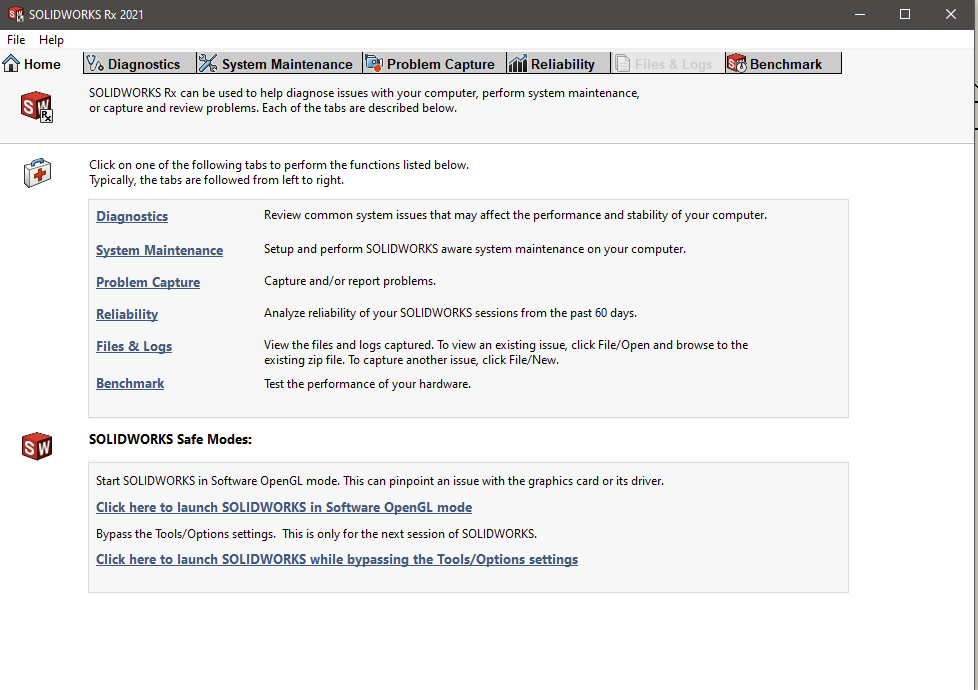

Open SW RX (by typing “rx” in your start menu) and open in both of the safe modes and see what that does.
