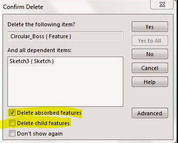

I believe this is what you are looking for:
Absorbed feature : Sketch inside a feature
Child feature : self-explanatory.
Nope. Looking to suppress not delete.

Yeah now I get it, I figured you were looking to delete a sketch that was absorbed by a feature, misinterpretation on my end, my apologies.

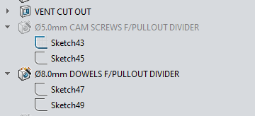

ex: Locating dowel built off the sketch of CAM. If I suppress the FEATURE, the sketches remain.
If I suppress the sketch, both the feature AND the sketches suppress. I like option 2

That’s all good Bryan, we all have our ways of working, if it works for you, then that’s all that matters. I was simply explaining to Mr. Perman why my screenshot was in english rather then french(as they usually are) ![]()
