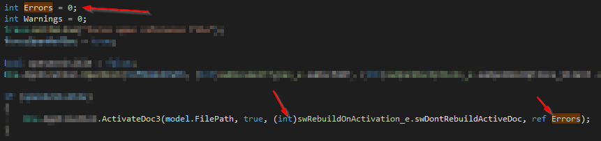

If I understand correctly, this is relatively common with solidworks constants. If you convert them to an integer wherever you use them, they should work.
This example is with c# but any constants need to be cast to an integer. Any variables that are returned by solidworks functions, such as the errors and warnings, are defined as integers.
Thanks.
