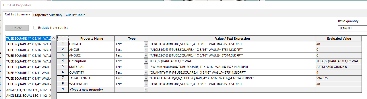

I have a multibody part file named 437514.SLDPRT. When I right click any cut list item in the feature tree and select ‘Properties’, in the Cut list summary, the Value/Text Expression for most of the properties are wrong. It looks like this:

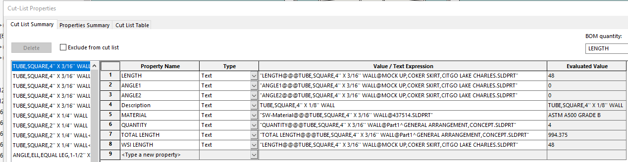

If I click on any other cut list item in the list on the left and then click back on the original, it shows the correct information:
I don’t use cut lists every day, so some of the inner workings are still a bit mysterious to me. Does anyone recall this as being a bug? We’re still using SW2017 SP5 (going to upgrade any day now, I swear).

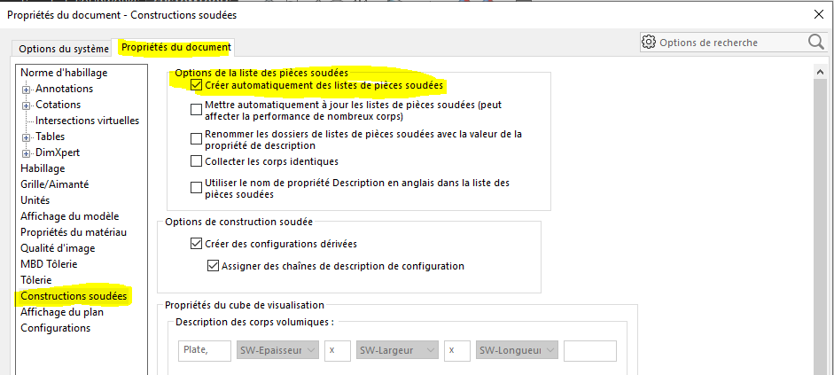

is the wrong name, the name of the part that was used as a “reference” for the save-as of the new part? If so, I’ve had this happen to me. Reported it in 2019, our VAR had provided a program to fix the issue and the suggestion was to have this checked:
In our case, we weren’t sure if SolidWorks or CustomTools was the culprit.
