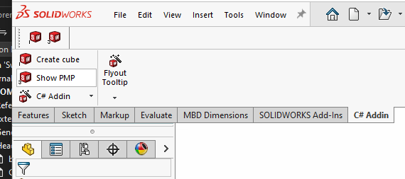

The original add-in template creates a VS project and generates the code to add a CommandGroup and a FlyoutGroup to the command manager. Then some custom commands are added to the command group and flyout group to do simple things like start Notepad, display a custom property manager page or show a dialog. The C# and VB.NET templates do something similar. The C# add-in produces this:
The strange thing I’m seeing is that in the C++ add-in, all the code to set this up succeeds, but all I see in the UI is the command group name:
The individual commands, the separator and the flyout are missing. In the actual toolbar, two commands appear, but as you can see they are disabled.
