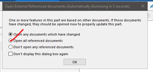

The ? means that the external reference is not open. Select the menu items File / Find References to show a list of References. Any that are not open will be marked “Not Open”.
When opening an assembly with external references, you should get the option to open all the referenced documents. If you don’t see this, you might want to go to your system options and uncheck it under Messages/Errors/Warnings
Dwight
JimLancaster To add to what to Dwight said, check this setting in options. For SSP, you want it to open all referenced parts. The description is bad as it only applies to part to part references. Assembly reference are always loaded.

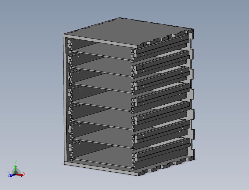

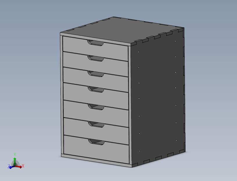

At the risk of bombing this thread with way too much detail, here are the results of my experiment:
My Seven Drawer Chest has one Case Assembly which contains the Case parts (side, back, top & bottom) and 7 instances of a Drawer Assembly. The drawers are of 3 different sizes which are controlled using Design Table configs. The drawers hang on french cleats. The top cleat attaches to the side of drawer, and the bottom cleat which the drawer hangs on attaches to the inside of the case.
In recreating the chest, I ran into an issue using derived sketches as recommended in the Barataria PDF. Both the top and bottom cleats are derived from the same two sketches in the Drawer SSP. The top cleat is obviously a part of the Drawer Assembly, but what about the bottom cleat? Is it more correctly a part of the Case Assembly?

In conclusion, I employed a more “hybrid” approach to using the SSP. The Case and Drawer assemblies both have SSPs that are stand alone parts within their respective assemblies, but the Drawer Cleat has the Drawer SSP part inserted into it. The model now appears to be working as expected, but I will continue to play around with it and see where it breaks.
