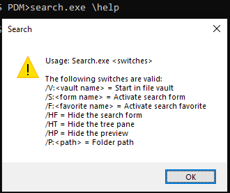

Does anyone know the command line switch (argument) to output the T-SQL code behind the Search.exe for a search card? I had it years ago and can’t find it.
This is all I can find at the moment.
Thanks…those are documented, we use a few. This one is hidden and I can’t find it. grumph
