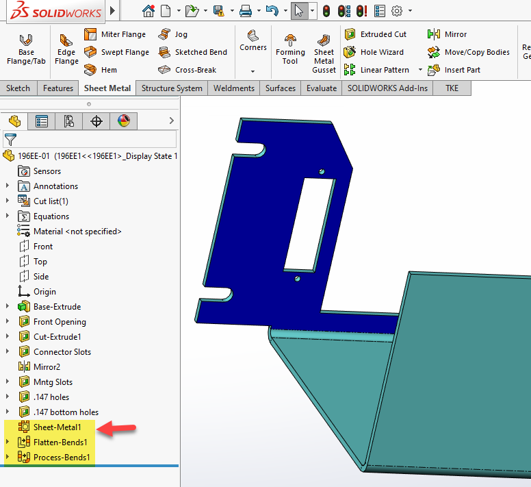

I am working on this file and I want to do a closed corner but the Closed Corner feature is grayed out along with some of the other sheet metal features. grumph grumph o[ o[ o[

How am I supposed to do a closed corner? What causes this!!!
We have had some other weird issues with this particular file, like cutlist properties resetting. I suspicion it is a template issue.
It appears like it was created in 2007!! Which might explain some things.
BUT WHY WHY WHY WHY WHY WHY WHY???
This is a massive multibody file so I am not about to remodel it.

This is the reason. I had this problem too. If you look at the feature tree you probably do not have a ‘sheet metal’ folder but only a feature.
This means that this part uses a f*ckin old template that causes numerous of issues (namely: greyed out ‘newer’ features, issues with the bounding box, issues with multiple flat patterns, issues with multi body parts, faces losing references after changing the part, flat patterns not flattening after changes; and those are only the ones I can think of right now).
Do not copy old sheet metal parts!

Nope, it is not that. In this part there is a “Sheet-Metal” folder with multiple “Sheet-Metal” features in it.
No, it’s not one of those either.

Now an explanation, but have you tried preselecting a corner face to see if this “ungrays” things?
Yes, same thing.
