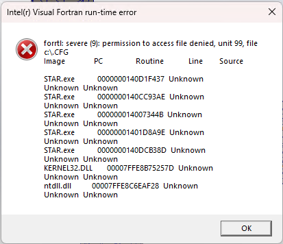

I’ve been working on this model off and on for several days. I made some changes this morning, and when I tried to run stress analysis on this part I get this error message:
I’ve had this happen in the past, and the solution has been to save the part outside of PDM, do my work, and then incorporate those changes back into the part stored in PDM.
Does anyone have any suggestions on how to work on models stored in PDM while running simulations?
Best guess, this is some sort of file system timing problem. The Fortran runtime is creating a file in the vault. PDM sees this and then grabs control of the file to officially add it to the vault. While this is going on, Fortran tries to open or write to the file but can’t because PDM still has the file lock.
Easiest fix is to tell Simulation to put the results folder outside the vault.

What is the name of the study that behaved badly? It’s interesting to me that the crash dialog shows that the file name is C:.CFG, which doesn’t make sense, since it should be C:<vault_location><study name>.cfg.
Perhaps Fortran doesn’t like something about that original study name.

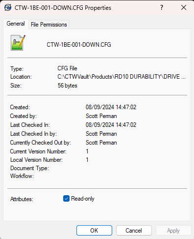

Nothing unusual about that name. Is there a Down.CFG file in the vault folder where the simulation files are being placed? If so, is it actually in the vault or is it a local file? If it’s truly in the vault, is the read-only attribute set, even though the file is checked out?

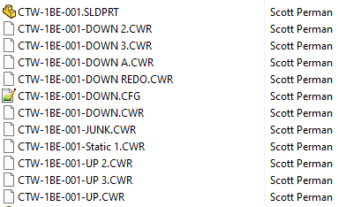

There is a .cfg file for “Down” and it is the only CFG file associated with that part.
Down, Down 2, Down3, Up, Up 2 and Up 3 were the original studies. Down A and Down Redo are from me diagnosing this problem.
Yes, on the read only attribute.
Thanks for your help with this.
If the file is checked out, the read-only flag should not be checked. I would uncheck it and see if the problem goes away.

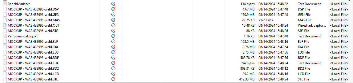

So, I had a simulation to run so I thought I would play around with this. My simulations did not generate a .CFG file, but apparently, that file is only generated if you use the FFEPlus solver. I switched to that solver and still didn’t see a .cfg file. However, all the other files that were generated were all local files that did not get added to the vault:

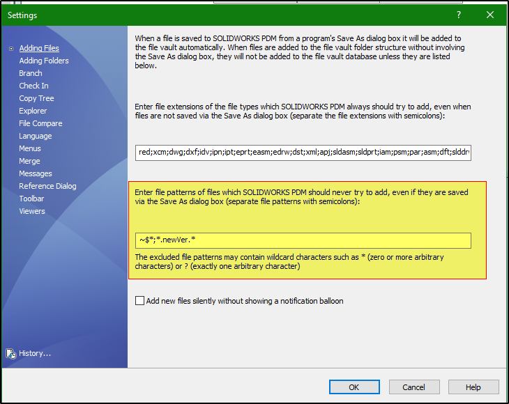

Would adding those temporary file types to the “never add these file types” list in user/group settings help?
Is PDM adding it to vault but then the SW cannot delete them per PDM permissions? Then the file checked in due to relations, but then when pdm service tried to remove the read only flag on local file upon checkout the file was already “locked by another process”?
I wasn’t aware of that setting. I will give that a try and see.
