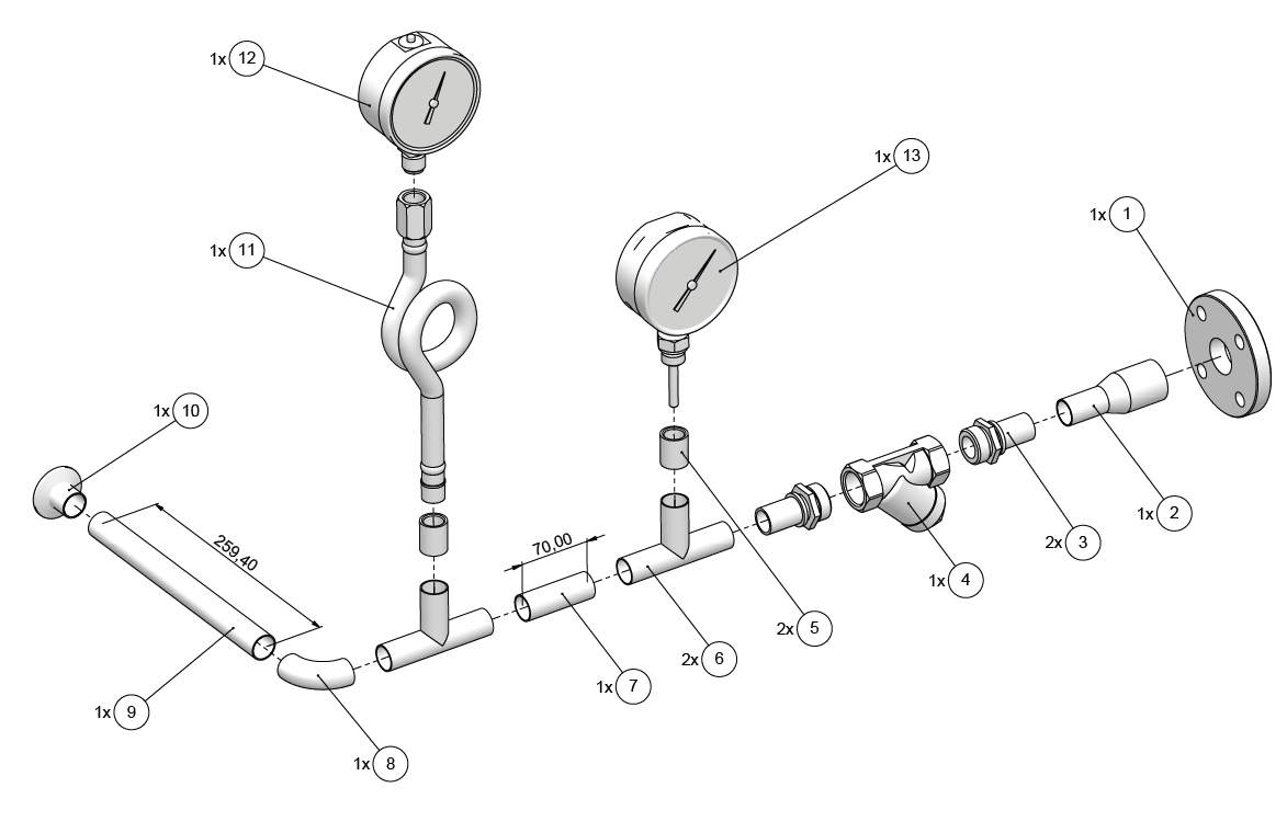

So, I made this custom routing assembly, using the routing module, and divided it into spools with different colors.

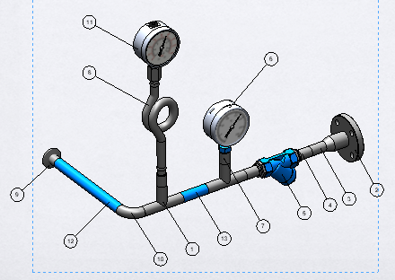

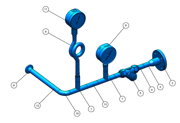

When I generate the drawings and have the views in shaded mode, for the whole assembly the view is ok (pic3), but when I put the spools views in shaded mode, they appear with the color with which I defined the spool in the assembly (pic 2). Apparently for some reason Solidworks override the apearences of the parts in the spool views, which themselves are driven by displays states that are created automatcly when the spool is generated.
When I expand the featres manager in drawing view (pic 1) you can clearly see the appearences spheres divided in half with one side the spool color that I difined in the assembly and the other half with the part appearence. I can’t modify anything, can’t delete the override material, not even possible to click on it. I have checked all options and the divided shperes don’t show up in the assembly featres manager, only in the drawing featres manager. I don’t seem to find anything and didn’t find any similar post about this issue.
Also note that sometimes when i swap between display styles of the view, some parts get shaded with the apearence and some stays colored (pic 4) and it changes randomly from parts to others sometimes even to sub-bodies of the parts.
