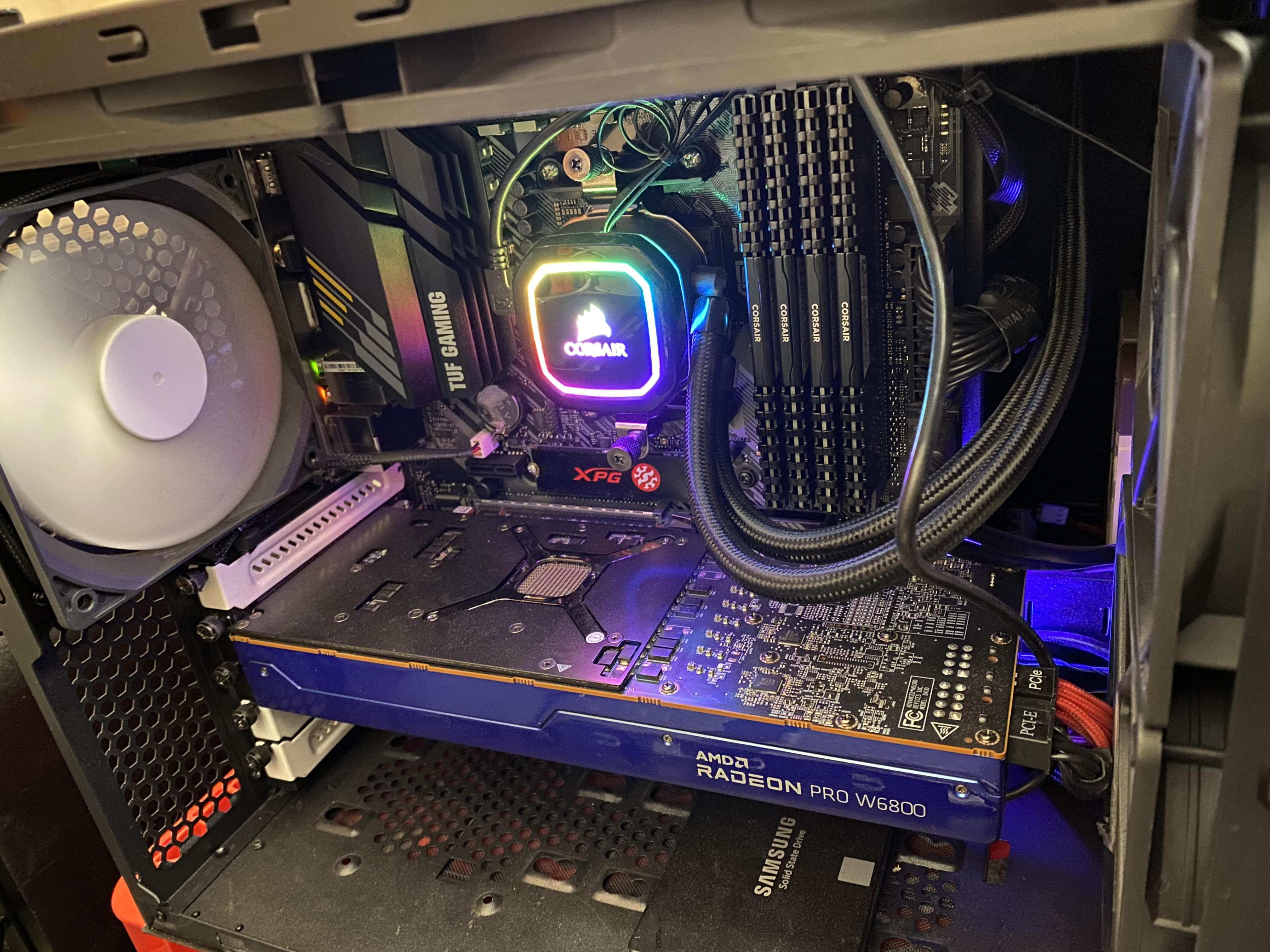

Is anyone else using the new AMD Radeon Pro W6800 yet on SolidWorks 2021? It has 32GB of GPU memory for that hungry graphics “performance” pipeline! I’ve been running it for a few months now. One of these days I will learn my lesson and stop living on the bleeding edge. It had a pretty bad gpu memory leak affecting solidworks in the 21.Q1 driver that seems to have gotten much better on the latest 21.Q3 driver. Realview works even though Solidworks still does not have the Radeon Pro W6600 or W6800 listed on the certification page, but https://www.amd.com/system/files/documents/vulkan-explained-radeon-pro-W6000.pdf and https://develop3d.com/visualisation/solidworks-vulkan-ray-tracing/ both seem to point at certification incoming in an uncertain timeline.
Even more interesting, those links also mentioned a new Vulkan based viewport being worked on at Solidworks to replace the current OpenGL one. That strikes me as pretty big news and worth discussion. They where apparently using a preproduction W6800 to demo the project romulan viewport in the Develop3d article above. We again have no timeline to go on, but I did notice a suspiciously named sldvkrsu.dll in my 2022 PR install that wasn’t in my 2021. Anyone want to join me in idle speculation?

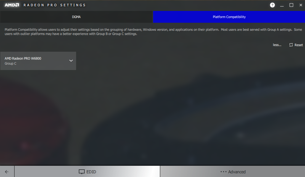

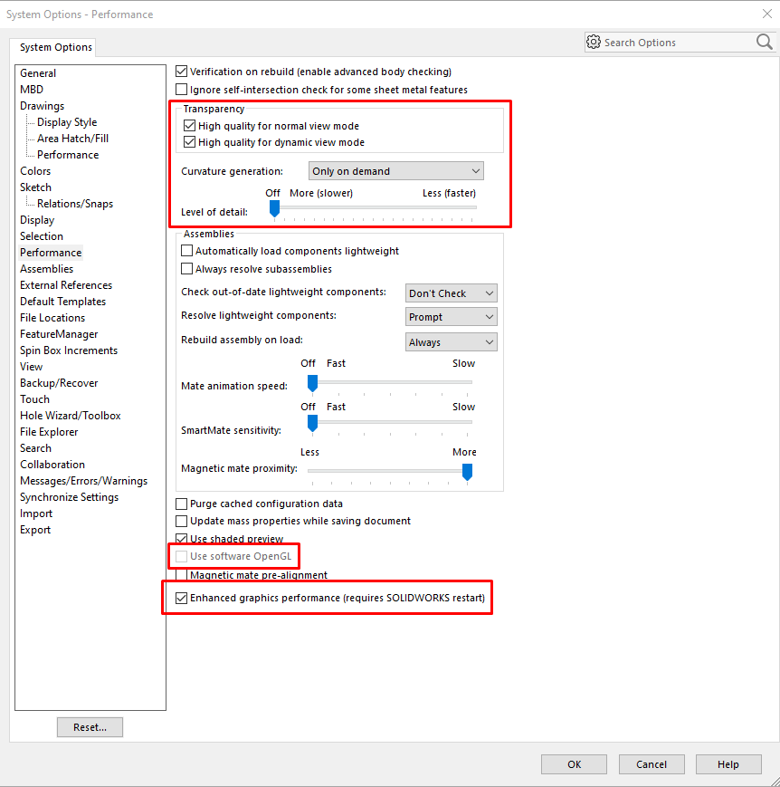

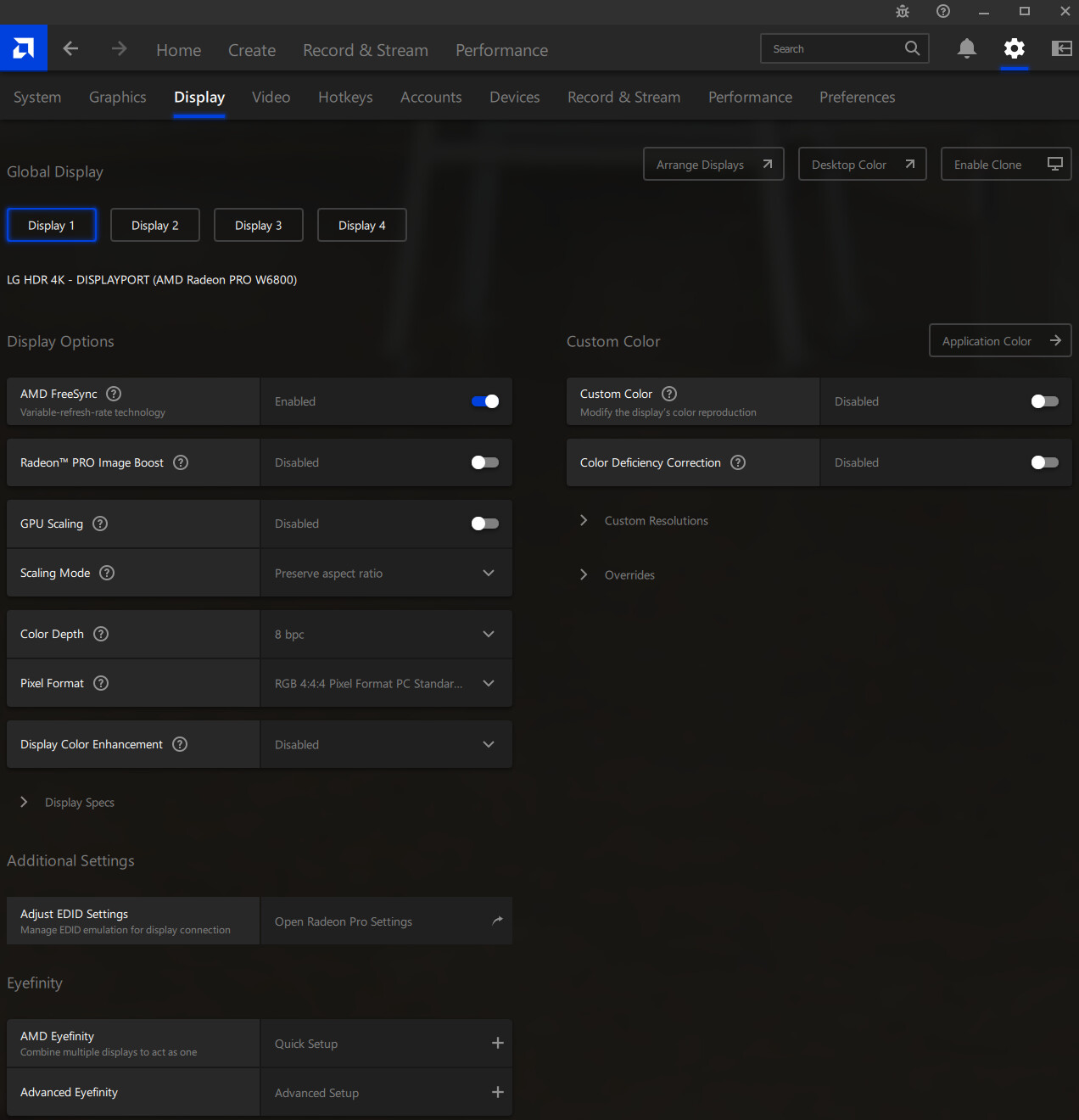

I unfortunately don’t have access to simulation installed anywhere, so can’t speak on it. Just in case it is still helpful, I’ve attached the Radeon and Solidworks graphics settings I’ve found work best for me in vanilla Solidworks. The big ones in Solidworks where turning draft quality ambient occlusion off and draft quality HLR/HLV on. Optimize for thin parts and Level of Detail slid all the way to Off also seems to help, but my testing was subjective and it might depend on your model. In Radeon Settings, set Antialiasing to application controlled with the SuperSampling method. I have OpenGL Triple Buffering on and Wait for Vertical Refresh set to Always on and it seems to help. I also set the very cryptic “Platform Compatibility” setting to Group C after much trial and error. This platform compatibility toggle is not documented anywhere I can find. Changing it seems to change a 0000/UMD registry value for GLPBMode (30 = A / 31 = B / 32 = C). My guess is it controls something about the OpenGL PixelBuffer.

P.S. I crave your build
Yeap, posted in another thread.
