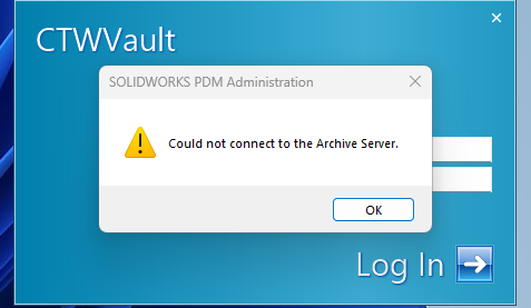

I am trying to setup Solidworks and PDM on a new computer. I’ve either forgotten a step, or I’ve managed to screw things up somehow.
As part of this process, I also upgraded the PDM server et al from 2024 to 2025.
I thought everything was going to plan. I was able to crate the vault view. However, I cannot login to the PDM client.
If anyone has any ideas I need the help. I’ve spent several hours on this over the last couple of days and I don’t seem to be making any progress.

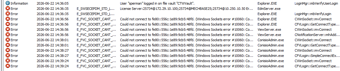

PDM isn’t supported on IPV6 networks. Make sure you have IPV4 enabled for your network card.
I think I did miss a step, or have something mis-configured.
disabling IPV6 seems to have made it happy!
