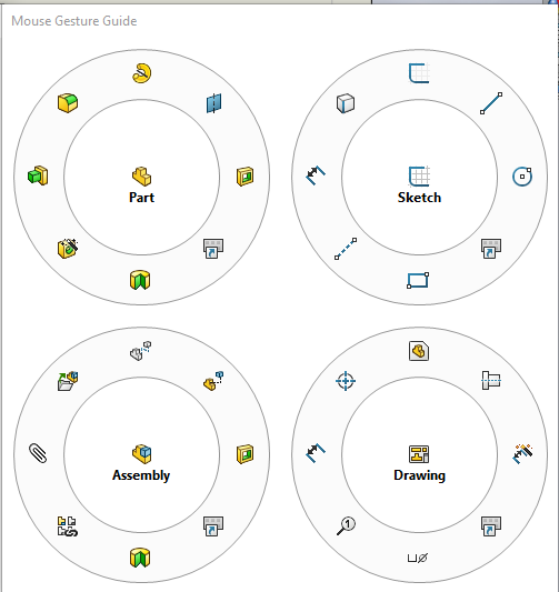

I will forever sing the praise of the S Key Menu in the bottom-right of the Mouse Gesture wheel.
Having to release the button on top of the icon would feel like a burden because as noted elsewhere you then need to pay attention to where the cursor actually is as opposed to just making the motion.
And if anyone tries to program anything to automatically adjust my UI because it thinks it knows better then I’m gonna start flipping tables.
None of the CAD systems seem to do true mouse gesturing like web browsers which allow for more complex movements.
Opera for example allows more than just straight line movements:
Between SWX and SE, the SWX implementation is faster and if you have it down to muscle memory, you hardly even see the actual radial gesture menu. The SE implementation is more like a “S” key radial style menu that you pick from, not really a mouse gesture IMO.
Thanks dave.laban, I just added the “S” key to my mouse gesture…nice tip.
I almost posted my gesture map yesterday, because I do the exact same thing - S Key menu at the bottom right.

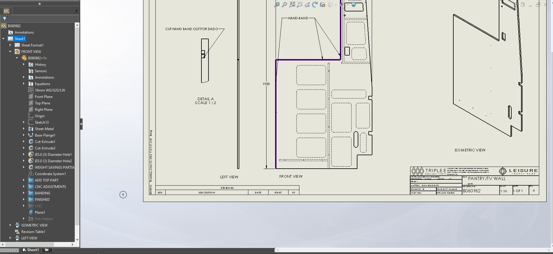

Mouse gestures in drawings are almost useless and WAY worse than i.e. the s-key:
  • They are slow in drawings - if you don’t pay attention the gesture will not happen at all
  • They often do not really work with your mouse over the view itself (it’s the same in 3D if you’re hovering over a part… because you have to click for them to appear…)
  • You can not pre-select something from the feature tree and THEN make a gesture to make it happen. Thus you cannot attach i.e. a balloon/note to an origin etc.
I disabled all mouse gestures in the drawing because of the reasons listed above. They are too slow/useless for me in drawings.
Hah, you got me there!
Interesting, I get the same process if I select something in the FMT then use a mouse gesture or click an icon in the Command Manager.
For speed, if gesturing in free space I don’t get any performance issues. I only have to slowly gesture if I’m trying to do so on top of model geometry (which is then when speed issues can show up). Wondering if there’s something different in our workflows.

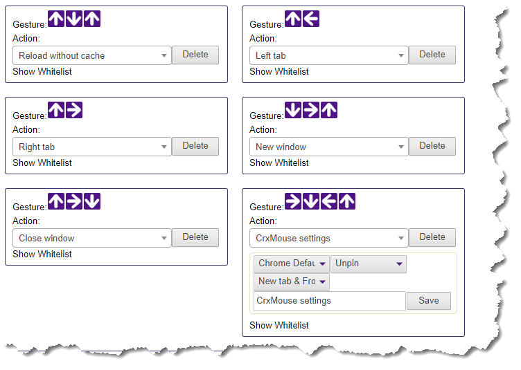

I always liked the idea of the multi-directional gestures in Opera but never found myself using enough of them to make remembering them worthwhile. There are only so many things I ever need to do in a web browser (most of which I’m happier using keyboard shortcuts for) that that much flexibility and customisation was lost on me.
Yes, Opera was the first browser to implement gestures. But Chrome and Firefox has gone beyond that.
You can set as many as 10 drags per gesture. <()>
That would help to speed things up even more, that if based upon preselected items, the context of what’s shown in the mouse gestures would be amazing!!!
How would that be significantly different from the existing context toolbar? (click to select, pick command - vs - click to select, click and swipe for command)
I can reproduce the issues:
Struggles adding a balloon:
Struggles adding a note:
The only way to do attach the note to the origin is by doing the mouse gesture OFF THE PAPER or by holding STRG while doing the gesture.
In comparison I can use the S-key even while being over the feature tree.
Yeah, right click is selecting the sheet and losing the tree selection. Not surprising that use case wasn’t tested, it’s a pretty obscure way of doing it.
Ahh, that makes sense. That’s exactly where all those problems come from. Right click DOES something before the mouse gestures are activated - and that is bad. I would immediately customize the button if it was possible. It would solve all my issues at once.
Using the S-key (as a comparison) is a much more consistent UI experience.
I’ll just mention Alin so he can suggest this feature at the next TTL…
In many instances, holding the control key will allow you to run a command while ignoring what is underneath the pointer. You might give that a try.
SoiledWorkaround.
I’m not sure it is bad. If you hover over a drawing view model edge and mouse gesture to add a note, the right click over the model edge registers the edge selection and attaches the note. Maybe they could make it pick up a preselection and ignore the right click selection.
