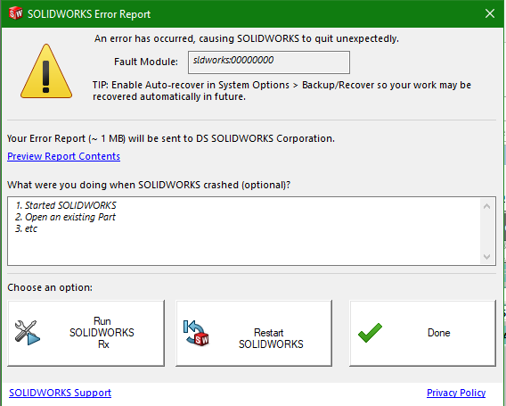

be glad it’s not these…
Oh I get those as well grumph
  • sometimes after I open a model and have done nothing, just zoomed/orbited around then … !!crash !!
That case is probably due to either a non-certified template or old drivers…
