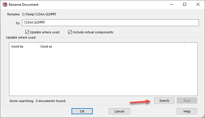

So I updated to 2020 SP.5 yesterday, and lo and behold its missing a primary function for renaming assemblies with virtual components. Originally in 2019 SP.5 - there was a “search” button: you would check the box “include virtual components” , hit the “search” button - it would populate those items, then you could rename your assembly successfully.

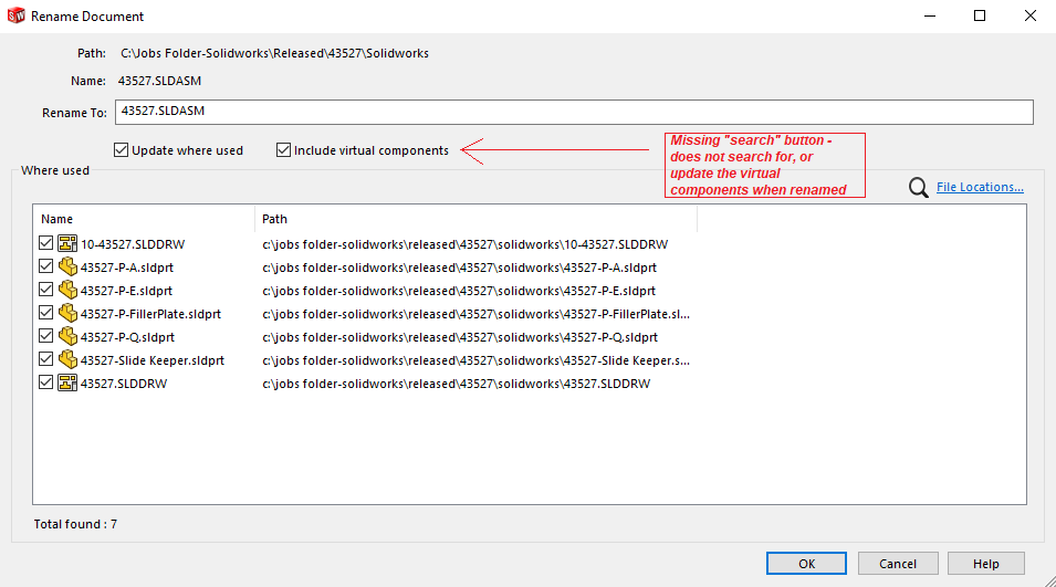

Now if you just check the box - there is not a search function - and as I expected after a test - the references of those virtual components do not update and reference the new name :frowning:
If anyone still has 2019 - they can probably verify the button I’m describing.
Yeah, you can tell they redesigned the dialogue, a lot of little changes.
Yeah, that’s the one. What a pain this is going to turn out to be… probably see it back in release 2022 SP.5…
Per the VAR: There is an open SPR for the issue…
“SPR 1194201: Virtual Component external references status becomes out of context after parent assembly is renamed”
Update..
My work-around so far is this:
Open drawing referencing the assembly you want to rename- open the assembly and rename it using “save as” with references.
Go to File > open > click on any other drawings that file is referenced in. Click on “references” in lower pane.
Double click on where the original file name is referenced and replace with the newly named file by browsing to it and selecting it from the list.
Delete the original after it’s been replaced in all “where used” instances..
