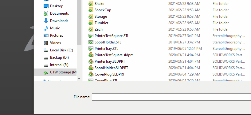

I don’t miss it, but I don’t like the new “file open” interface. (I think it changed when they took away solidworks explorer. Maybe it’s been this way longer than that.)

This always puzzled me. Opening a file is the most basic operation and they’ve invented about 15 different ways to query what you want to find for just (3) different file types. It’s become very convoluted..
And they haven’t nail it down yet.
So you’ll see another 1251 ways.
