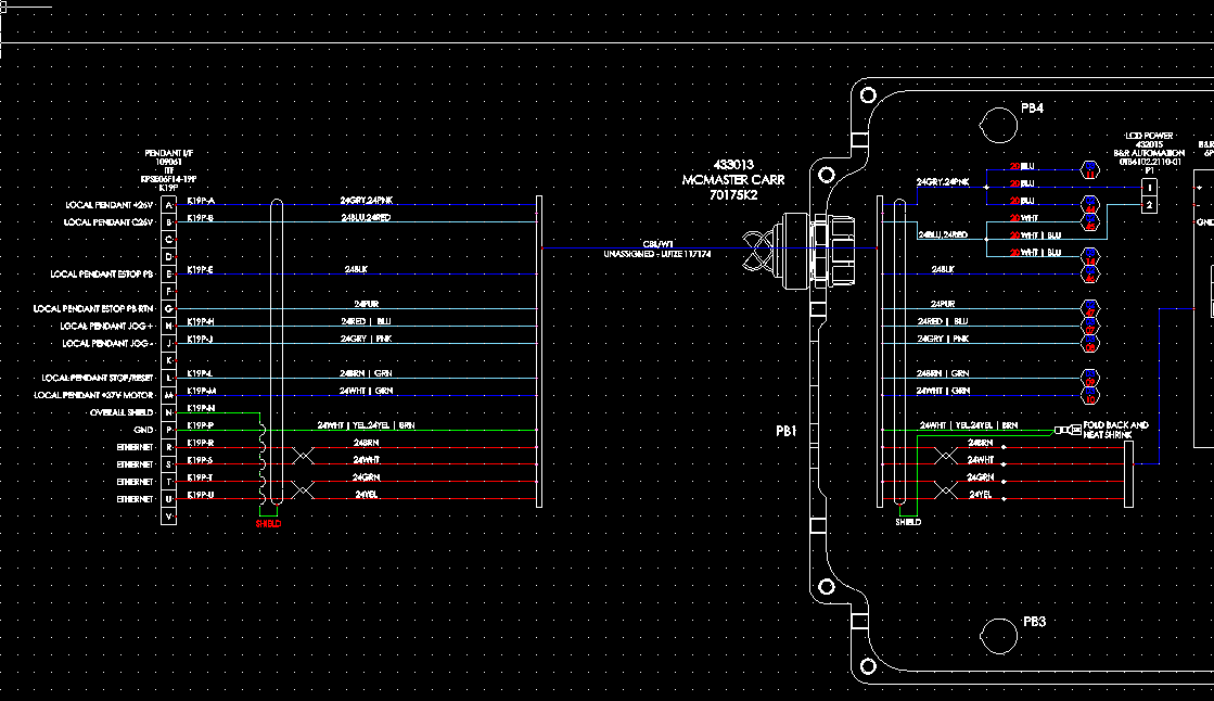

I’m trying to find a robust, simple way to create a cable fanout. Here’s something close to what I want:
Ideally, rather than cable core texts, wire labels would be shown, but that doesn’t work. I can get a label on one side but not the other. Also, this arrangement is very fragile and will often revert to something like this:
It also gets exponentially slower as more wires are added.

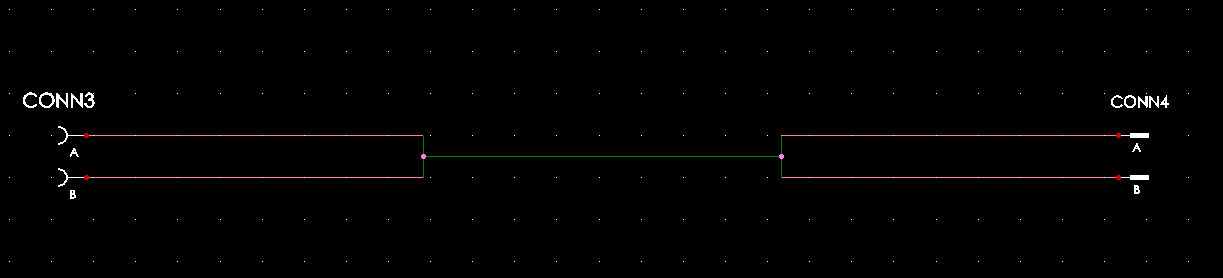

So, to get things to look like the first image, I start with a mixed scheme and draw the wires like this:

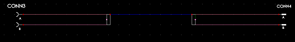

I then move the central wire to a hidden layer and add two line diagram symbols and draw a cable between them:

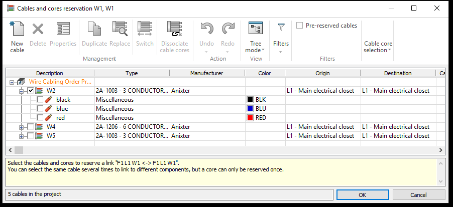

Next I reserve the cable (deselecting the cores) :

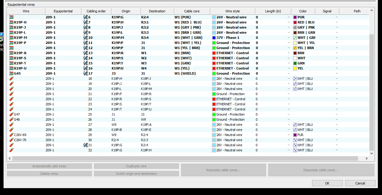

And wire numbers are the problem. If I add wire numbers at this point, the wheels start to come off:
Note that the left hand wires are each showing an extra wire (12V-26). The extra wire can also be seen in the associate cable cores dialog. If I go back to ‘Wire cabling order’, I can delete the offending wire, but it will inevitably come back at some point. Just going back into the wire cabling order dialog, or right clicking on wire is enough to trigger its recreation. As the number of wires increases, so does the number of extra unwanted wires. For example, I have this:
which has 15 extraneous wires:
