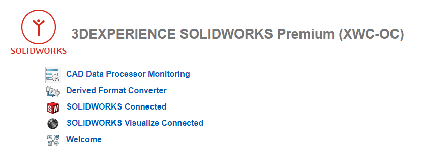

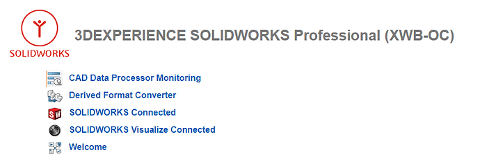

I stumbled across this page when poking around. Clicking on the ‘Roles’ category and then ‘SOLIDWORKS’ reveals 18 different roles! Good luck figuring out what you need. From those 18 roles, 3DEXPEREINCE SOLIDWORKS Professional lists these 5 ‘apps’:
3DEXPERIENCE SOLIDWORKS Premium lists the same 5 apps!
