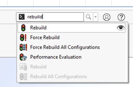

Then there is a rebuild for configurations that you should try instead of Ctrl-Q when making those kind of changes. I assume it was added for problems like you are experiencing.
Can you share some screens? I’d look at BOM settings as David stated. There is a setting that regroups all configurations as one, I believe if that setting is set then SolidWorks will only reflect the configuration of the oldest occurence.
BTW Force Rebuild All Configurations shortcut is SHIFT + CTRL + Q instead of the usual CTRL+Q

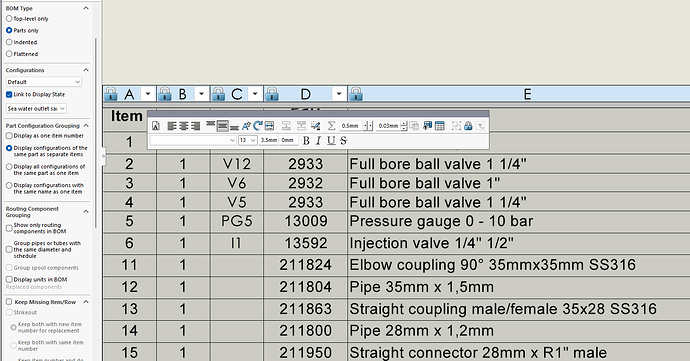

Here are 2 screenshots as example. 1st without pipes grouping and needing to hide items in BOM, but references are displayed ok (item 2-4 are the same parts with different configurations where 2 and 4 are the same config but different reference).
2nd with pipes gouped and SW also groups the valves. see item3 2x valve partno2933 reference V5. the reference V12 is no longer showed in the BOM.
I tried all options in the BOM control without any luck :frowning:
