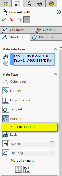

The ā€œLock Rotationā€ option on Concentric mates has been removed…!!
These screengrabs are from my 2022 SP5.0 version.
These below are from my 2024 SP2.0 Version.
Unless, it has been moved to somewhere else that I cannot find.
I’m sure you all know how it is to scan down the feature tree looking for the tell-tale Minus sign in parentheses to confirm that everything is fully defined.
I’ve often just used the Lock Rotation feature to achieve this when rotation of the part is not relevant.
Now we need another separate and different mate to have the same function I used to get with 2 quick clicks.
Why would anyone want this…?
The lock rotation feature is there in 2024 SP5. Typically, when that feature isn’t available, it means SW thinks there are already existing constraints locking rotation about that axis.
This is interesting… I definitely did not have other mates defining it. It was showing up in the feature tree as (-).
But… This morning it is now there. I can lock the rotation.
The pics I posted yesterday were of the exact same assembly I opened this morning to find it now working.
Now I assume it was either: as you say, there is a new something that determines whether or not to disable the option.. :confused:

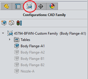

Has anyone else on this version been subjected to this nonsense??
From what I’ve read, its got something to do with 3D experience, but we don’t run any of those add-ins.
This is the only part I’ve configured that has changed to this terminology at a random time.
There was NOTHING wrong with calling them configurations / derived configurations!

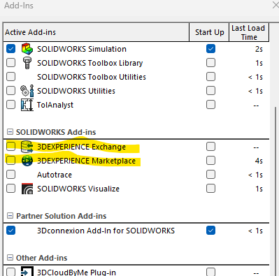

Just Dassault taking something simple and making it complex for no reason, as they’ve always done. It indeed has to do with 3DXperience, I think it was introduced in 2024 but I’m not sure, but I definetly read about people not being happy of that and encountering issues linked to that.
Do you have either of these add-ins turned on?
No, I do not - all 3DX add ins are disabled. Its weird, the part wasnt even updated to the latest version upon saving. The library component in which i started with still shows the classic configuration icons and terminology, and has recently been modified in 2024, so is current.
The epitome of ā€œchange for the sake of change.ā€ No one would ask for that, the classic way is already crystal clear.

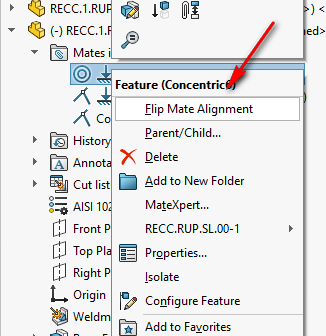

Maybe you already know this, but you can right-click on the main Mates folder (below the inserted components and above assembly features) and Lock all concentric mates, instead of doing them individually. I typically insert a group of hardware, and then do that to lock all the concentric mates.

No, I did not know that. I can see it there and after having clicked on it, it works a treat.
Despite never being surprised at how little I actually know, it is always a good day to learn something new.. :slightly_smiling_face:
Thank you Glenn
I honestly always had issues with locks on concentric mate when the mates are not done as SolidWorks wants them to be done. I’d rather add a parralel mate instead, I found that it often removed rebuild issues that would be fixed by toggling off and on the concentric lock from the Mates Folder as Glenn pointed out.
