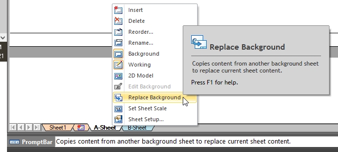

jcapriotti is correct except for the last part. The way to move, copy, or transfer background sheets is to RMB on a background sheet tab.

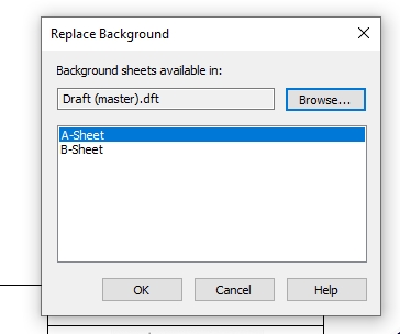

Then select the file that contains the desired background sheets and copy them over.
A similar procedure is used for annotation and dimension styles; set up the template(s) with the correct sheets and styles, then if you need to apply those to older drawings you can do so with a wizard-like tool.
