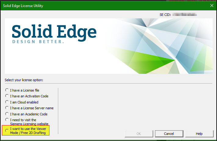

I’m a few years old on Solid Edge data but back around ST6 / ST9 era they dropped the stand alone free viewer (Draftsight maybe?) and just shipped the full Solid Edge but when the License Utility popped up user could select “I want the free veiwer/ free 2D drafting” option.
I just checked our 2019 installation still has that option, looks like this:
So that was free for commercial use, we could install and run that on all the machines we wanted. I never used the “free” 2D drafting, didn’t need to. I cannot speak to what is the most current or what they plan for the future, but that’s the history that I know of the progression of the free viewer/2D drafter.
