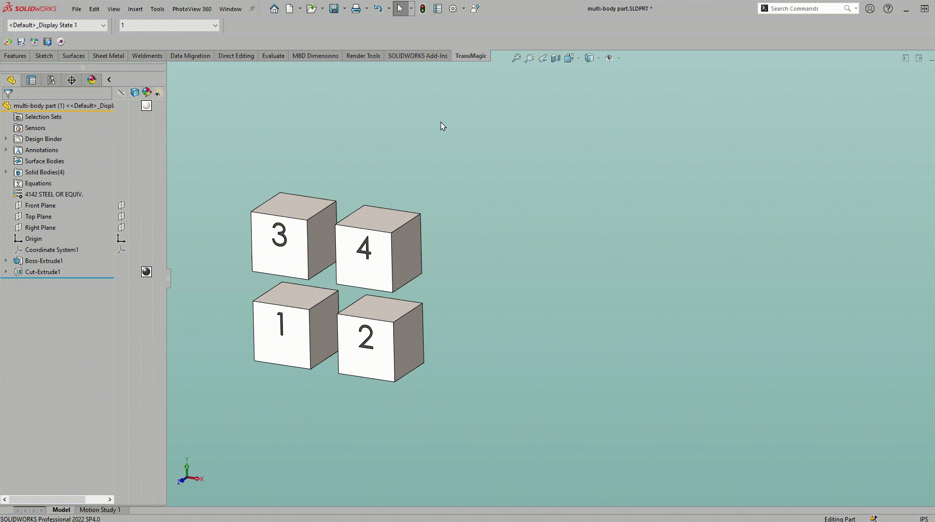

solid bodies saved out as unique parts
I know how to cut this solid into segments like sketch which will result in separate bodies within the part file.
Q1) what is the best workflow to make these bodies as separate standalone files? Specifically they will be .STL or similar format for 3DP. Seems to me I just hid the ones I didn’t want, then file save as name1.STL, rinse & repeat.
Q2) Side question & maybe what I’m getting hung up on another project. I brought a few instances of a similar multi-body part into an assembly & selectively turned bodies on & off between the distinct parts. It seemed to me selecting specific bodies of part-1 was simultaneously affecting part-2. I can provide a better example of this but I can’t recall how (or if I did) ultimately fix this. Possibly I incorporated configurations which suppressed unwanted bodies vs just hiding them?

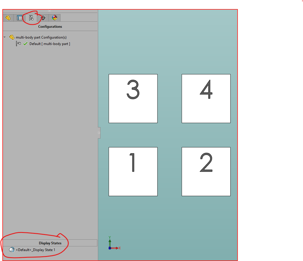

In answer to question 2:
Using configurations should work. You mention hiding bodies but I would either suppress them or use the delete/keep bodies feature to control with configurations.
Thanks. I’m aware of & written VBA macros in Excel but its on my immediate to-do list to get up to speed in SW.
If I’m understanding this macro, it saves out any & all bodies it sees in the part file using their existing body name?
If you are hiding the bodies (and not suppressing features), then in order to have one instance show one set of bodies and another instance show a different set of bodies, you will have to use Display States.
You will need to set up the display states first at the part level to show what bodies you want to show in each instance.
Edit: Here is a better explanation:
Here is my part:

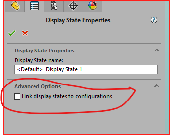

Go to your Config tab to see display states:
First, go to properties:
To check whether or not this box is checked:
If you check that box, then a set of display states will “live” with their configurations. If you have multiple configs, then it will create 1 display state for each config. If that box is checked and you create multiple display states, all of those particular display states will only be available for that particular configuration.
If that box is NOT checked, then each display state can be used in any configuration.
Configurations tend to control “physical” portions of the CAD model (suppress, unsuppress, dimension changes, etc…) while display states control the graphical portion (hidden state, colors, etc…)

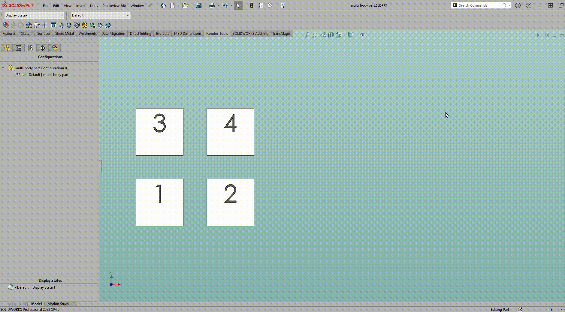

So you can do this one of 2 ways:
You can control your hidden states of each body by using configurations and make sure that the above checkbox is checked, then make sure to hide/unhide as needed and it will carry though the different configurations.
OR
You can control your hidden states of each body by NOT checking that box, and then no matter what config you select, your display states will control the hide/unhide.
The first way with linked display states (This is a GIF…click it):
This is the second way (another GIF…click it):

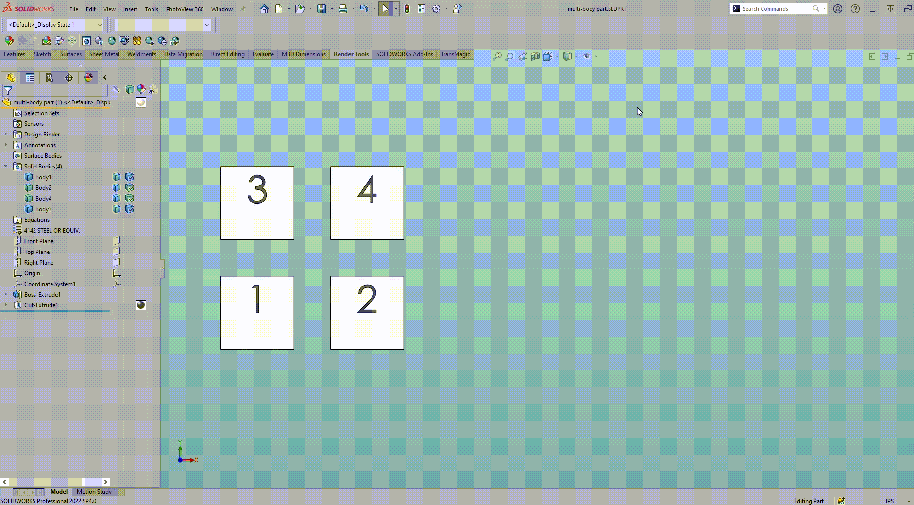

Here is a way to do it with Suppressions and configurations (This is a GIF…click it):
That is another useful technique Dan. Thanks for video, shows the steps very clearly

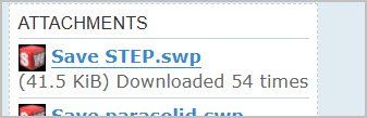

Re Q2 maybe answering my own question. Should have checked the Macros area. I just saw mention of a STEP exporter macro, but I need to check if its the all bodies capability
https://forum.cadmunity.com/t/re-sharing-my-macros/3352/1
