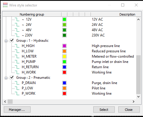

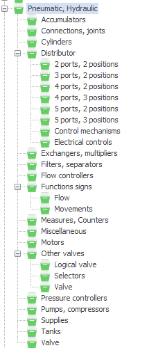

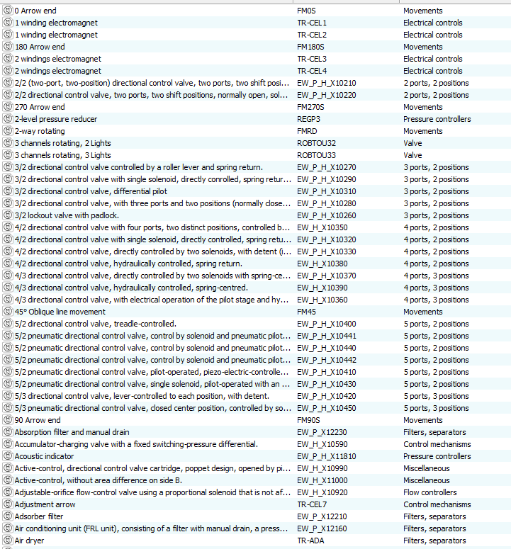

SOLIDWORKS Electrical will do hydraulic and pneumatic schematics.
The built in symbol libraries include hundreds of items. This is a small sample:
I haven’t used it for pneumatic/hydraulic but they would work the same as the electrical side which has a lot of potential if you take the time to use it as intended and set up your library of manufacturers parts. You can start with just the 2D schematics package and expand to 3D with full blown cable, wire, hose routing later.
The 2D schematics package is very AutoCAD-esque in operation but has some SOLIDWORKSish bits as well.
