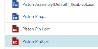

I found myself making questions to ask here, only to find you answer them later in the blog. One thing that I missed or wasn’t clear enough for my density. You mention that there’s CAD ability in the platform but likely using tool like Solid Edge for anything more than simple edits. Does this imply that a Solid Edge file can be uploaded to the system and then edited natively, saved, then downloaded and still able to edit in Solid Edge or is it “dumb solid” translation between desktop and cloud like some other system we know?

When I first put a Solid Edge file in, it went in as a *.par file - Solid Edge format. But when I edited it inside of Zel X, it was converted to an NX file - *.prt. The edits happened in a way that looks like a synchronous edit. Then I downloaded it to my local machine, and I couldn’t open it in SE after that, even when telling SE it was an NX file. Making edits creates a new version of the file, and it makes you save it with a new name. It would be nice if it automatically included a revision name in the new file name.
I think this is supposed to work. Not sure why it doesn’t. If I get an answer, I’ll report back here.
matt Perhaps a version issue due to ZEL X probs using the latest Parasolid version…
What I heard from the YouTube product launch video Zel X is based on NX. So it will read and write NX files. But what I don’t understand is why Siemens would bundle Zel X and Solid Edge (Classic and of course, it has to be XaaS version) together!

There is a great interoperability between Solid Edge and Zel X. Here is a video where I use Zel X (latest update) and Solid Edge 2024 UD7 and you see that I’m using a part from Zel X and place it into SE assy…
https://youtu.be/51yjrk1_SnY
Parasolid version issue? Siemens handles it well. ![]()
