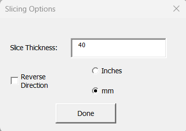

I have this macro for slicing objects that the excellent AlexB made for me. It does exactly what I need, and responds well to changes in construction history. It has just one small inconvenience, in that it can’t tell the direction of the selected object.
So if it’s applied and nothing happens it has to be deleted manually and reapplied with “reverse direction” checked.
Does anyone here have a good idea how to read the right direction?
Something like detecting the normal of the selected face, or maybe working double sided?
