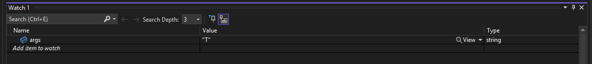

Everything works, except that somewhere along the way the String passed to the CallBack function is truncated to a single character:
This happens for both a Windows Forms app and for a SOLIDWORKS macro. I can’t try a C++ app since I don’t have the C++ bits installed in Visual Studio at the moment. Has anyone used SldWorks::CallBack successfully with the String argument?
C# returns LPWSTR, but it needs BSTR, as written in “Remarks”. It could be like this:
public static int test([MarshalAs(UnmanagedType.BStr)] string args)
I can’t check the functionality. :dashing_away:
It has been a while since i used it. this is what i found in my notes:
When SOLIDWORKS calls your add-in using CallBack, the final argument is passed as a BSTR (COM string). If your C# method just uses string args, .NET may misinterpret the string (it defaults to LPWSTR, that includes a hidden length prefix), which can cause truncation .
you should explicitly tell .NET to treat the argument as a BSTR like this:
i see that mikhov is faster than me… and we are saying the same :smiley:
MarshalAs(UnmanagedType.Bstr) works, almost. Rather than a a one character string, I now get a string consisting of the correct value followed by the null terminator \0 followed by a slew of random characters. So for my purposes I can extract the correct value by finding the index of the null terminator and then using Substring to chop out the bit that I need.
Seems like SW may not be properly initializing the BSTR (as described here) before passing it along.

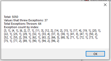

So, my BSTR issue is resolved ,but this leads to the next problem. To make sure this is reliable, I created a little test. I call the SldWorks::Callback method in a loop, passing in the loop index and keeping a running total on the add-in side. So for a loop from 1 to 10, the total should be 55. It is 55, every now and then. Most of the time it is something less than 55. So I increased the loop from 10 to 100 and added a little bit of code to catch exceptions and keep a count of retry attempts. A typical run gives results like this:
So nearly 40% of the calls throw an exception with some of the calls failing as many as 5 times before succeeding. Every subsequent run is different, but the failure percentage is typically 30-40%. Adding a Thread.sleep() to slow things down made no difference. The failure rate was still about 40%.
The exception seems to always be the same, RPC_E_SERVERFAULT, which points to a Win32 exception being thrown on the SOLIDWORKS side. No real way to determine what’s going on.
Seems like I’m just going to have to brute force retry SldWorks::Callback for a period of time or a number of attempts and hope that SW does what it is supposed to do. This is not good programming practice, but my hands are tied.

CallBack, as you can see, is 40% unreliable - a complete failure. Even if
args?.Split('\0')[0]
works, it is still creepy and slow and leaves a bad feeling somewhere in the soul.
Maybe global variables? Or other technologies that I don’t know at all.
According to my VAR, reports are that SldWorks::CallBack is extremely dodgy and should be avoided for performance-sensitive or repetitive tasks.
On top of the 40% failure due to Exception rate, I’ve also noticed that a large percentage of the time the argument string doesn’t make it through the transition from outside the SW process to inside the SW process. So once again, I’ll have to repeatedly call the CallBack method until it succeeds or until the number of retries exceeds some value and then punt and inform the user.
I’ve come to the conclusion that the SOLIDWORKS API has had zero testing. No respectable programmer would test something, have it fail 40% of the time and say “Looks good! Ship it!”.
