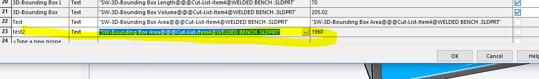

Works for me in 2018. I know that at one time SW had a glitch in it so try this. Go into the value/text expression and put a space right at the end right before the last " and enter that.
I know that prior to 2018 SP5 a lot of things would not evaluate in weldments but if you did the above it would magically fix itself.
Thanks for the suggestion. I tried putting a space in before .SLDPRT and after the last " without success. This is on SW2020 SP5.0.

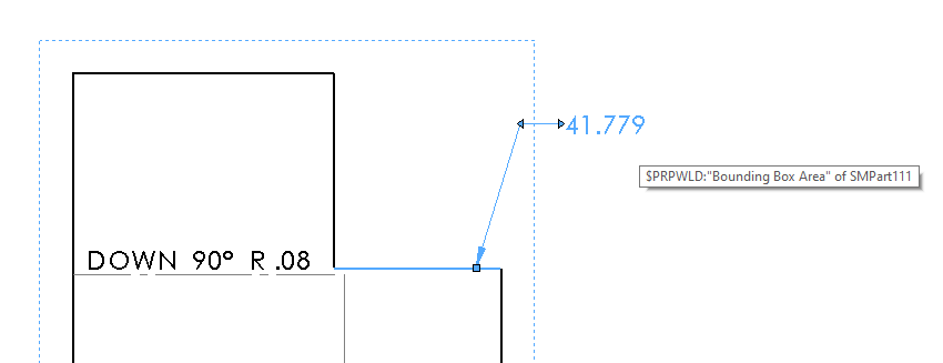

You can use any of the cutlist properties associated with the flat pattern.

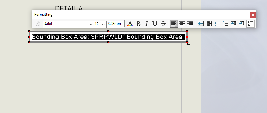

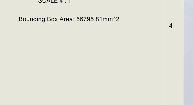

These use $PRPWLD and the note must be attached to the flat pattern view (which doesn’t have to be within the drawing’s border).
This note is $PRPWLD:“Bounding Box Area” (without any added static text or other linked properties):

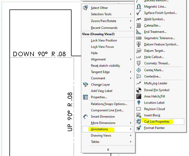

Right-click the edge of the flat pattern’s view and select Annotations>Cut List Properties:
This creates a note of several $PRPWLD’s (one per line), from which you may inspect and copy what you need:

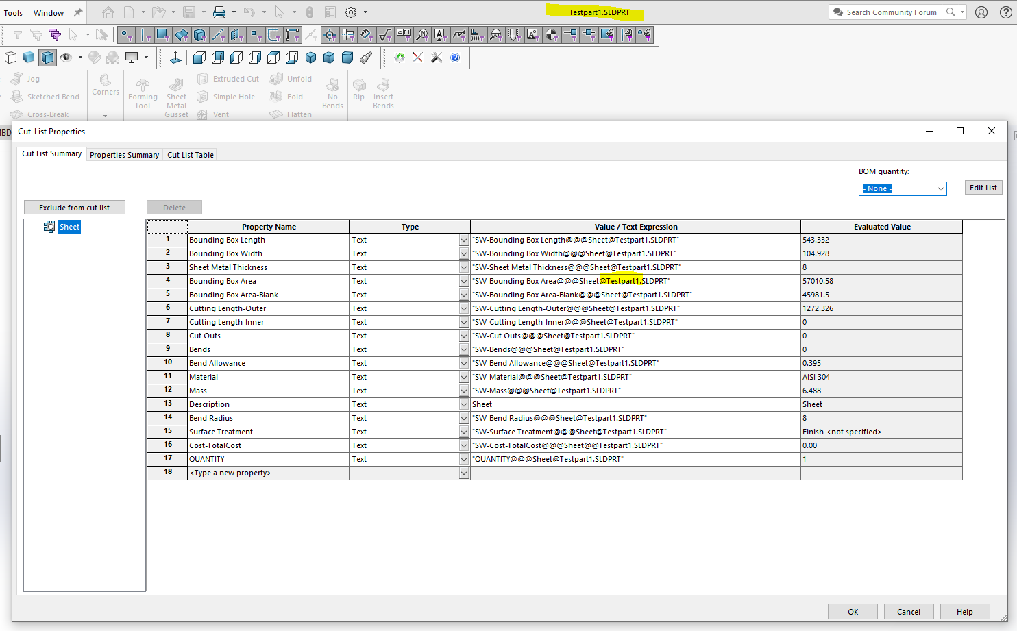

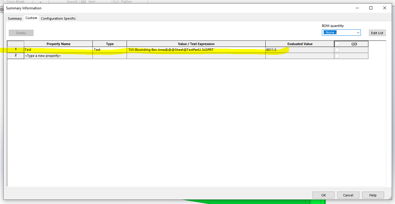

A little more information on this problem. First, by creating a brand new part, Testpart2, a custom property linked to the Bounding Box Area can be created. See attachments Pic13 and Pic14. This helps on new parts created going forward.

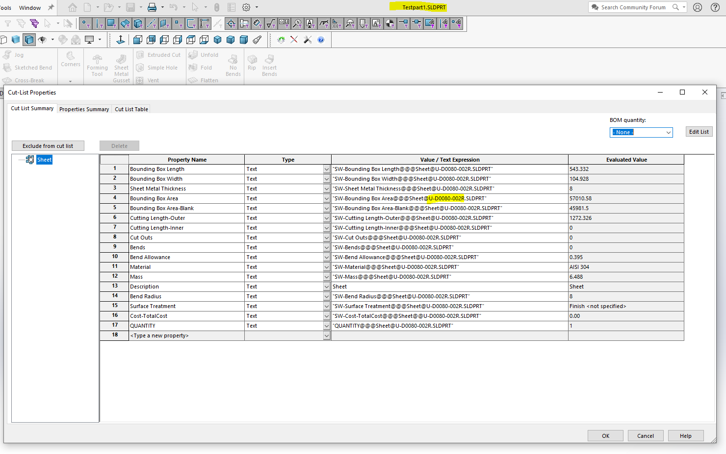

Second, using an older part yields an even stranger issue. This part is Testpart1 and see attachment Pic9.

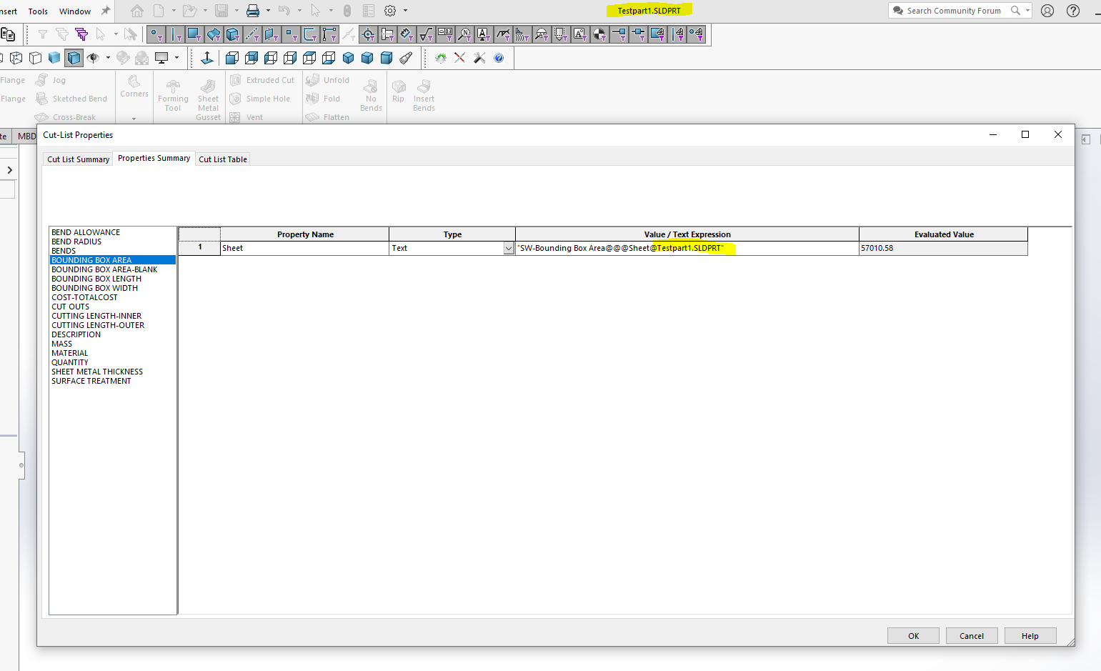

The current file name and the cut-list property filenames don’t match (note Testpart1 vs U-D0080-002R). If Properties Summary tab is selected (see Pic10),
the current file name updates to Testpart1 and when Cut List Summary tab is selected (see Pic11),
the filename has changed to Testpart1. Selecting OK and then reviewing the cut list properties again, the old filename of U-D0080-002R appears again (see Pic13).

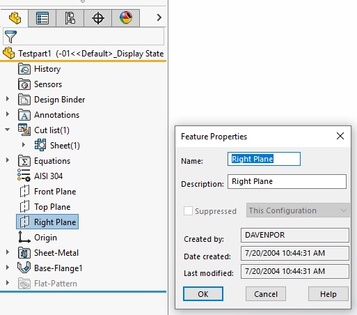

Your template dates from 2004, according to the primary plane properties. This may not be your problem, but it is known to cause weird issues with custom properties. Can you recreate the problem with a fresh template (2020)?

Just to be clear, template age is determined by the version used to create it, not by the last saved version. Testpart2 is from a fresh template, coincidentally or otherwise… :smiley:

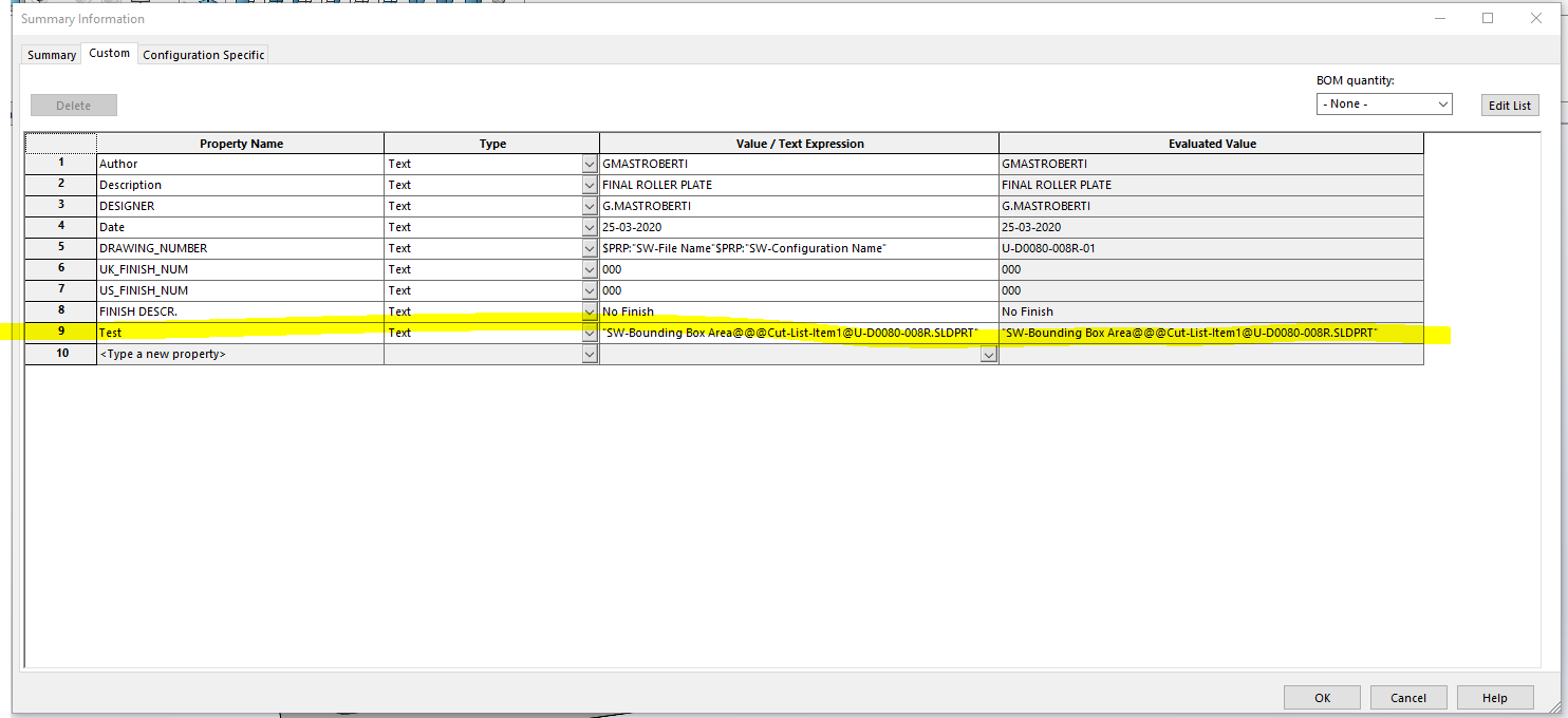

Thanks for the responses about deleting the cut list! I then promptly tried to link the Bounding Box Area property to a custom property which will not evaluate. See Pic15 below.
