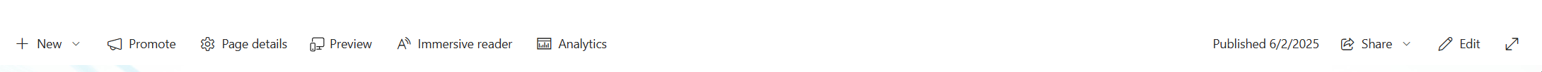

We are using Sharepoint with a bunch of different pages for different topics. It’s a reference for the whole company (small company about 100 people at 3 locations) with each discipline having as many sub-pages as they need. We even have a “Where is it” page that just lists where you would find things like company released procedures or NDAs. We have it set up so that anyone in the Team can edit or publish pages.
We have a company wide Microsoft Teams team that this is under. When I access the SharePoint site for that team in a browser and go to the first page we have set up (called “Start Here”) there are a bunch of linked pages. If I wanted a new one, I would just select new from the menu near the top. I took a screenshot of the menu area where we can add or edit pages.
I’m not sure if this helps get you any closer.
