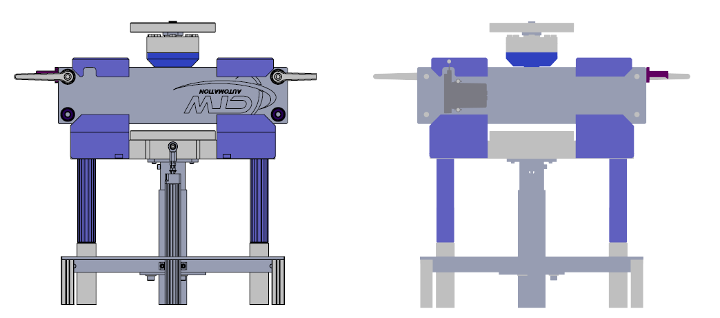

Shaded with edges view, saves to PDF as shaded.
This is what it looks like in my drawing:
This is what I get when I do a “Save As PDF.”
Any ideas on how to solve this problem. Ideas that don’t involve my graphics card or my templates, preferably.

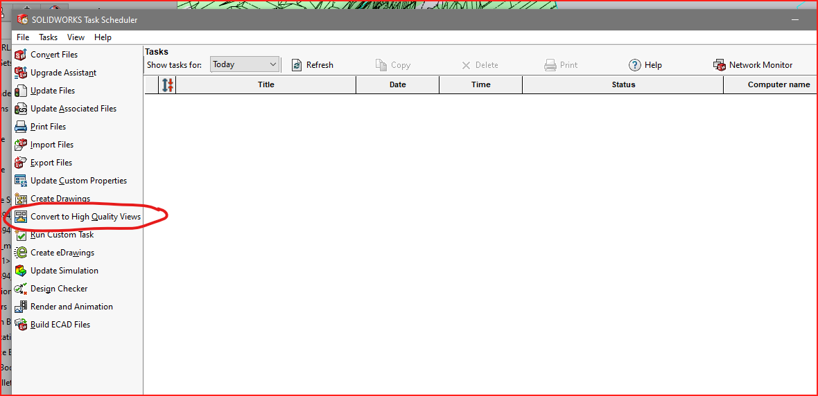

If you have a whole bunch of drawings that need to have views converted to high quality, then you can use the Solidworks Task Scheduler:
(I have never actually used that specific command yet, but I use the “Export Files” one all the time)

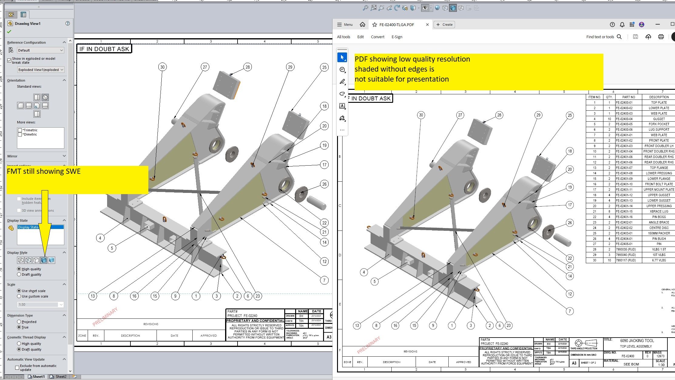

Am having the same issue,
it does seem to be related to the view property manager in my case.
When I save SW changes the view from SWE to shaded,
then dwells for 20 odd seconds then the view reverts to SWE,
I have to wait during the dwell then confirm the save.
Glad I found this before using the VAR solution of reverting to factory settings.

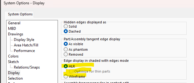

I tried printing to pdf vs saving to pdf. I tried changing between draft quality and high quality. I tried changing the settings recommended above. I tried rolling back my video card driver. I tried all combinations of this setting.:
Nothing resulted in all 4 pages of my print being displayed properly. Fortunately, the problem page changed from export to export, and I wasn’t over-writing the files, so I was able to do in Adobe what I couldn’t do in Solidworks.
