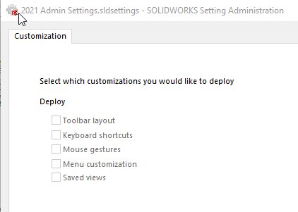

I suppose I’ll try locking a few things just for the heck of it… Sorry for all the questions. Did you pull in any menu customization as well?
No Toolbar layout, Keyboard shortcuts, Mouse gestures, menu customizations, or Saved views are deployed. I just went through the available System Options in the tool.
I never came back to this to answer, but yeah it appears I’m able to import most things just fine, but menu customizations and toolbars, etc, do not seem to pull through. Oh well.
