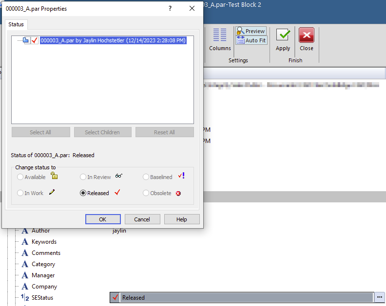

As to setting a specific part to Obsolete, this can be done using the File Properties form, specifically the SEStatus property.
Thank you for your response.
I seemingly am not able to change the status after it’s released because it’s read only.
Is there a setting for this in SEAdmin? I have to get our admin to install it so I havent been able to check it out yet.

Jaylin, are you set as the "Document Controller (see field on the Vault Definition page or set in the SE Admin tool if using Options.xml)? I believe only the Document Controller (I thought it was called Change Coordinator) can change status on Baselined/Released/Obsolete documents.

Thanks. That fixed it. I had to enter my user as a document controller. I can now change the status through Design Manager but still not through File Properties form.
