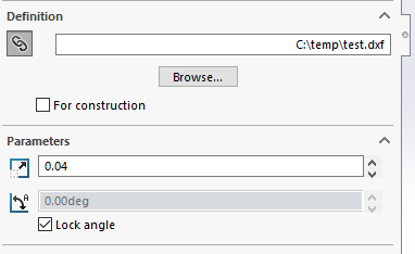

I’ve been experimenting over the weekend and discovered that you can drag a dxf into a sketch and it becomes a sketch block.
Pretty cool stuff, but there is no import options dialog to specify the units and somehow the dimensions are coming in as inches, so my 100mm edge becomes 2540mm.
My part templates are all in mm.
I can fix this by applying a scale parameter in the block properties but it would be nice to make it just work.

I tried this with a dxf I exported from SW and it worked, so guess the problem lies with my usage of the netDxf library
