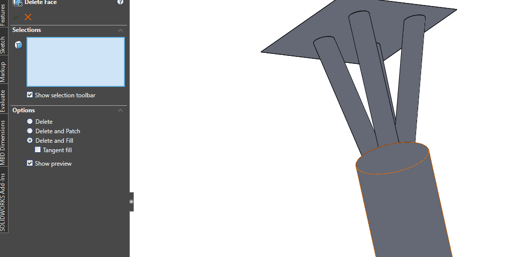

When trying to select objects for an operation, if I use the selection window, instead of just adding anything inside the window, it deselects anything already selected. Is there a setting for this somewhere?
Please see the GIF below:
This seems to be typical behavior. Think about it. You essentially selected that component twice, and therefore it is removed from the selection set/group. I’d say this behavior makes the most sense to me.
I disagree. It is inconsistent. If you pre-select faces before selecting the delete face tool, you can use the SHIFT and CTRL keys to alter the behavior of the window select tool while selecting more faces. CTRL will toggle any already selected items, while SHIFT will ignore already selected items and add any new items. When the delete face (or other tool) is selected, the CTRL and SHIFT keys are suddenly ignored and the behavior changes to all toggles all the time.
