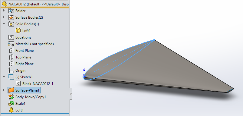

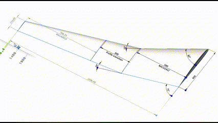

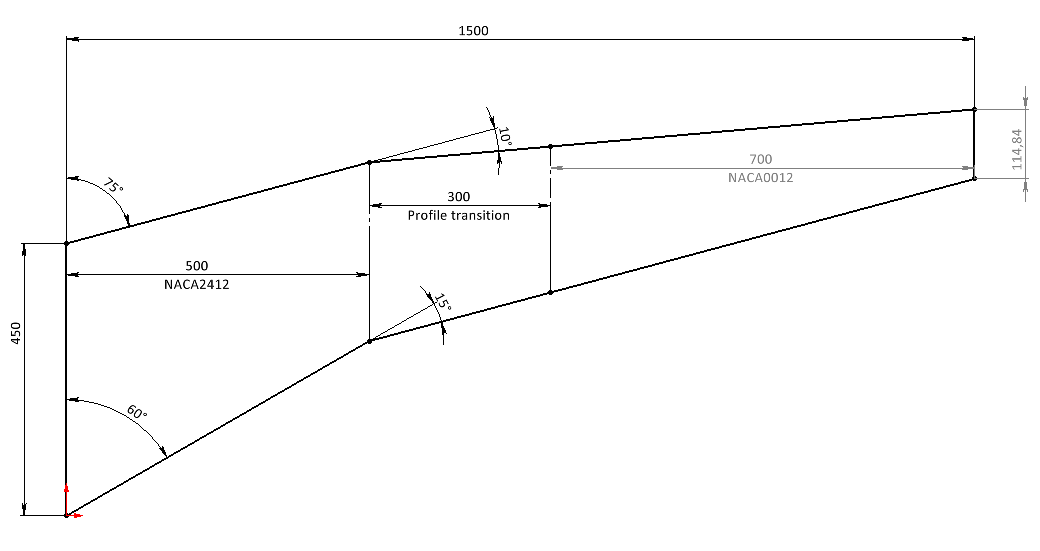

A few improvements to the gristle variant (I think)
  1. Create an auxiliary model for each profile that we want to use.
  2. In the model, create a boss by sections: From the original profile with a chord of 1000 mm to one reduced by 10 times (100 mm) at a distance of 1000 mm. (Here we decide that we will not use a profile with a chord size less than 100 mm and more than 1000 mm, if we do, we expand the range).
  3. Also create a line dividing the profile by the chord, and scale it according to the coordinate system so that the chords of both profiles lie in the plane above (see the NACA2412 and NACA0012 files)
  4. Create a Wing part, for example, with a complex contour in which one profile passes into another.
  5. Add our auxiliary parts with profiles to the part with the wing and place them on the start and end lines of the section with the profile, according to the size of the line.
  6. Create a plane on each line of the beginning of the end of the section with a sketch of the intersection with the corresponding profile body (here we get the profile contours with the required scale (by line size)
  7. Create a boss by sections for Section naca2412 and naca0012. And also a boss by sections between them for a smooth connection.
    We do not consider the applicability of this wing for real world use!*
    Wing.SLDPRT (524 KB)
    NACA0012.SLDPRT (96.1 KB)
    NACA2412.SLDPRT (115 KB)

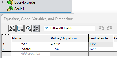

Access via dimension does not work.
“Scale1” = 1.22
“D1@Scale1”=1.22

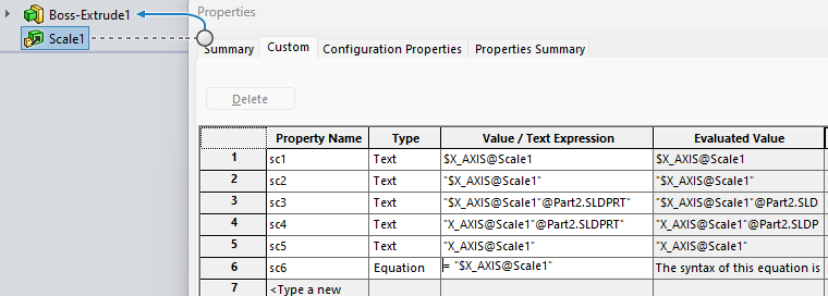

Access via configuration parameters does not work.
Access via design table works.
“$X_AXIS@Scale1” * *
It is not possible to get the properties configured by the user.
