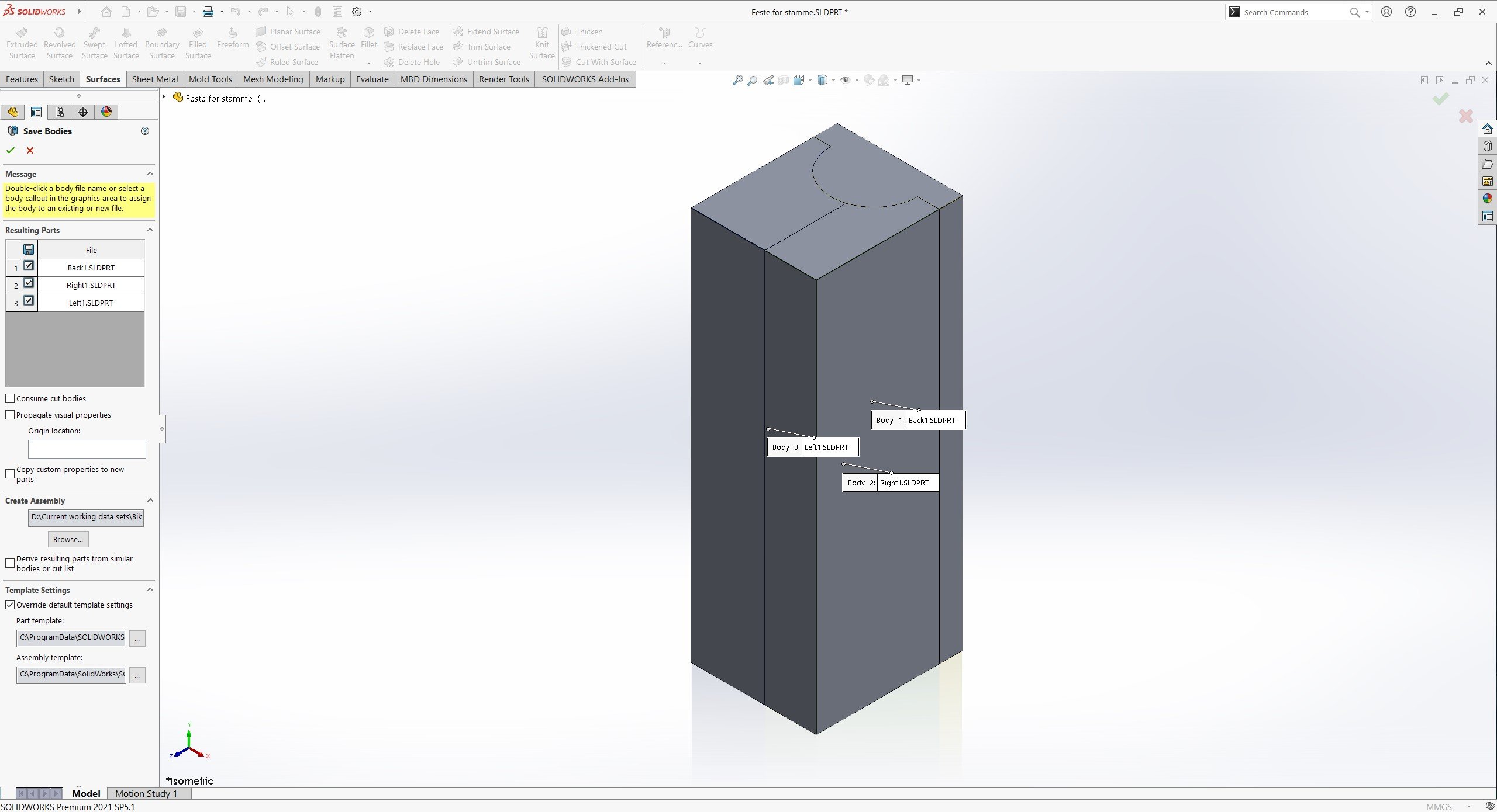

So I’m trying to save out the bodies from a part file to an assembly, but when I browse for the file location and click save, I get this error message that doesn’t make any sense.
My Solidworks version 2021 is installed at default location on the c:drive. I’ve tried different locations on different drives, but get the same message. I’ve looked into default file locations in solidworks settings, but can’t find any who refer to the location on the error message.
When I look at the menu for Save bodies I see there is no option for override template settings for assembly, just for parts, but in the help menu it shows that you can override both parts and assemblies location.
Any tips on how to get by this, so I can save the file?

Basically save out the three parts without using the assembly option, then open each part separately, then do a save as on the part overwriting its name. Go back again and do a new “save bodies” command, give new names to the three parts and the final location you want for your new assembly and name the assembly.
As you also can see now the feature has the missing link to the file location for the assembly template location. Hopefully next time it will work without any kinks.
