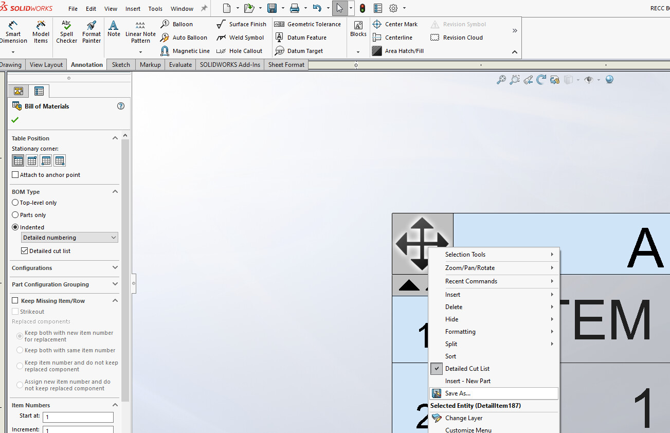

So, I have a top level assembly that I am trying to save the BOM out as an Excel Spreadsheet. Admittedly, I do not do this often but I am trying to expand my capabilities.

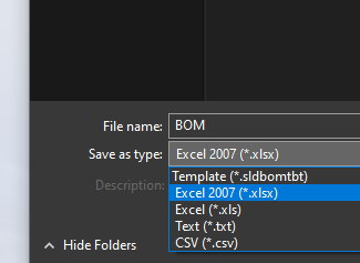

It seems to not work tho. When I right click on the table at the top left corner I get the context menu pop up and I select “Save As..”
I scroll into the filetype drop down past the BOM template option and choose the Excel 2007 (.xlsx) filetype and type in a name and hit save.
The software pauses for a few moments, as one would expect while it works away at it.
But there is no file saved and no warning or dialog given. It just goes back to being ready for the next command.
Am I doing something wrong..? Or is something broken in my 2021 Version..?

UPDATE:
So it turns out that I can indeed create Excel files from the BOM as one would expect.
It simply would not allow me to save it to my chosen directory.. Which is weird because I have full administrative permissions and all other solidworks files save ok to this folder.
That said, I tried saving it as a .CSV file and that worked fine and when I opened this file, everything worked as expected.
But when attempting to save it as .xlsx within Excel, this is when I finally got a warning that I could not save to my preferred folder. (SW said nothing and gave no indication that it couldn’t or wouldn’t, it simply didn’t do anything at all..)
Instead I saved it to my drive’s root directory and this worked fine. (I checked all the usual things, characters, filepath length, etc. no issues there but…)
Experiment time: Back to solidworks, repeat all steps to create Excel BOM, save to same root directory, SUCCESS..!!
Odd.. It seems this is likely the issue, even if I cannot fathom how/why..
But mission accomplished. And although I still do not have any clue why solidworks and Excel will not save xlsx files to my preferred folder, I have an acceptable workaround.
