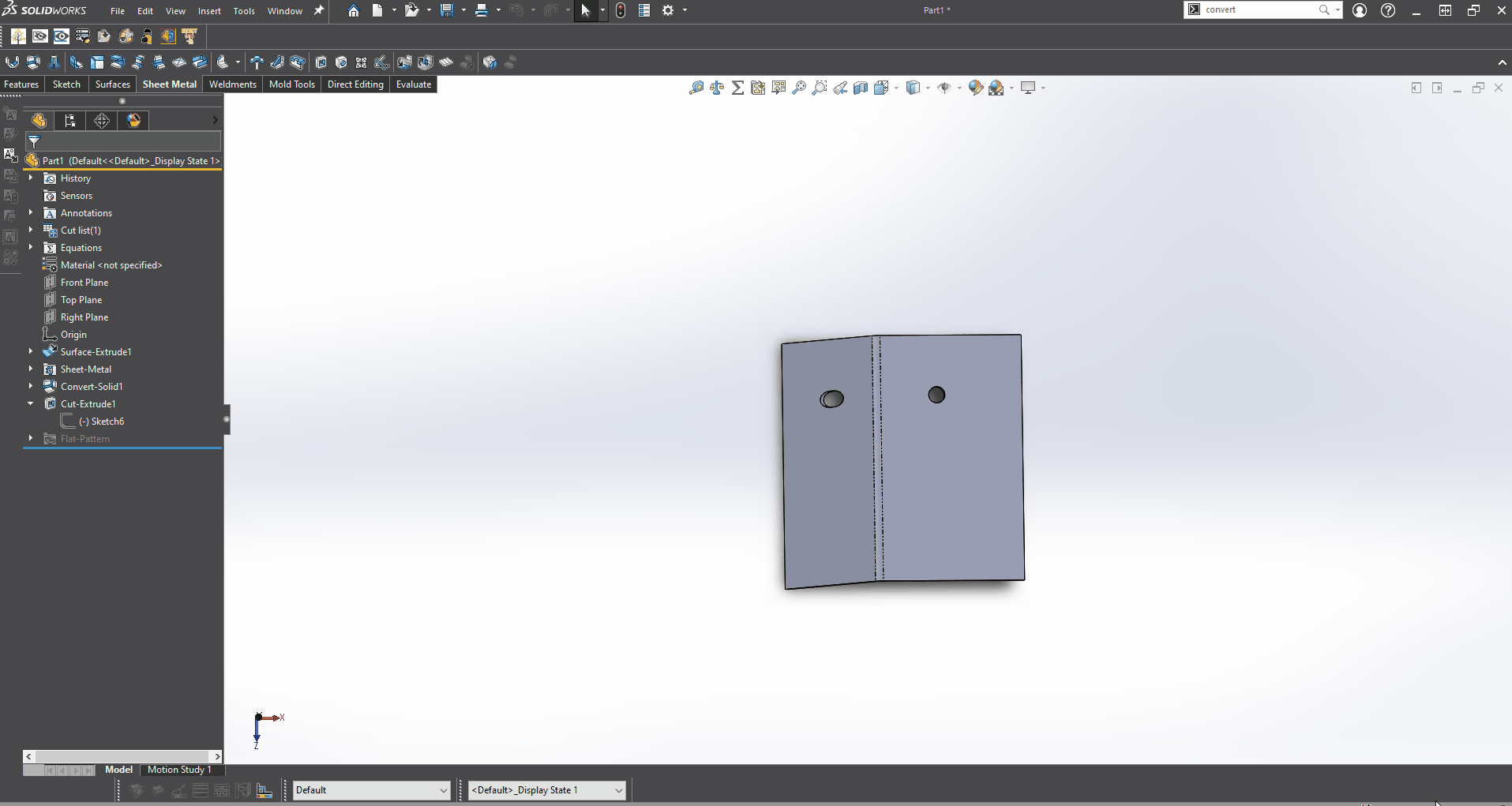

Not only the thickness is a problem here, but also the bending radius! If you cut a hole on a flat sheet as a circle and then bend/roll it, its diameter in the axis transverse to the bending axis will change. It’s normal. Just like the fact that the hole is made in a 3D model and developed as an oval.
If you want actual holes in your flat pattern you will probably need to make them on the flat pattern you are cutting out.
On tis part the holes are partially in the bend
Here is what our laser software produced for the flat
You can see because the holes is partially on the band it flattens the one end because when it’s bent it would stretch that end of the hole. IN pratice it doesn’t come out perfectly round. In this case it’s fine for what I needed on this part, but in other cases I would remove the ob-round holes and put an actual circle and then burn that if it had to be round. But when you form it the hole will no longer be true circle.
Ultimately, you need to figure out if the form, fit, and function require the perfectly round hole, since that would take some kind of secondary operation to achieve.
Not completely. It is stretched and compressed at the same time. Depending on whether it is the outside or inside of the bend.
