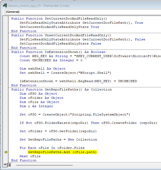

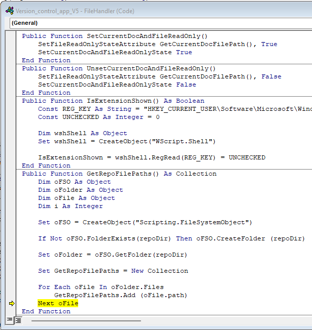

-When I “Step into” and then F8 repeatedly, I get in a loop here:

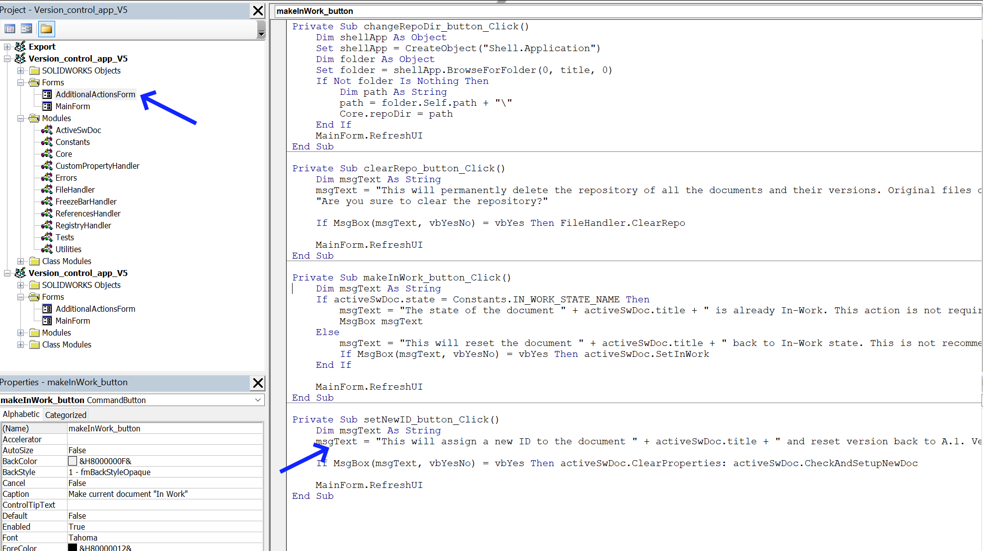

-Where is defined the sentence “This will assign a new ID to the document xxxx.sldprt and reset version back to A.1. Versions associated with the old ID will remain in the repository. Are you sure to proceed?”

This is a loop that traverses through all of your files in the repo directory, you probably have quite a lot of them, that is why it appears to get stuck. You can add a breakpoint after the loop and press F5 to run the macro until that breakpoint, it will save you a lot of time.
This is from AdditionalActionsForm:
