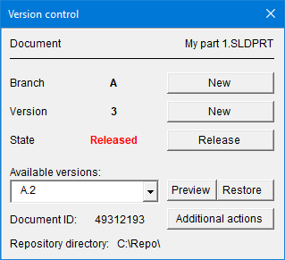

User Interface:

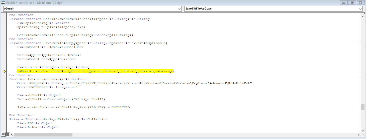

But here it didn’t work :frowning:
When I click “New revision” or “Release revision” the file is not saved in the Repo folder
I ask to debug and an error appears on the line:
Can you tell me what could have happened?
IModelDocExtension.SaveAs3 was introduced with SW 2020, are you using an earlier version than 2020?
If that’s the only issue, you can try replacing it with SaveAs2:
swModel.extension.SaveAs2 path, 0, options, Nothing, Empty, Empty, errors, warnings
I’m using SW 2019.
There’s the problem. :nerd:
I tested it with SaveAs2 and it worked fine.
Thank you very much!!! :smiley: :smiley:
Hi guys, after some time I returned to this macro app, found some bugs, things to improve, etc. So here’s version 3.
Release V3
Changes:
-It is now possible to use the app for a component while editing it in-context in an assembly.
-App now correctly detects document changes, as well as when all documents are closed.
-UI has been renewed, showing the title of the document it is controlling to reduce confusion, as well as the directory of the repository.
-All Released documents are made Read-only, all their external references are locked (configurable), and Freeze Bar is used to freeze the whole feature tree (configurable). This should help with Top-Down designs.
-However it is possible to force a released version back into In-Work state through a dedicated button.
-It is now possible to quickly change repository directory, and this setting is persistent. This should be useful if you want to have separate repositories for each project, so they don’t mix.
-It is now possible to delete all version tracking information for a part, to reset it back to A.1 with a new ID in the repository. You can also clear out the entire repository with another button.
-Names of the Custom Properties, and the values (“In Work” / “Released”) can be changed for localization.
-Major refactoring. Should be much easier to read through the code if you want to customize the app per your needs.
-Added a test suite, current coverage around 80% (most untested stuff is in the UI, which is a major pain to test automatedly in VBA editor). If you make some changes, and want to make sure nothing in the app is broken, run Modules->Tests->TestAll. Prepare a test part (any part) and any assembly (it that contains the part), and run it. Make sure you edit the path to these test models at the top of the Tests module.
-Renamed the app to “Version control app”. Someone told me this is more accurate.

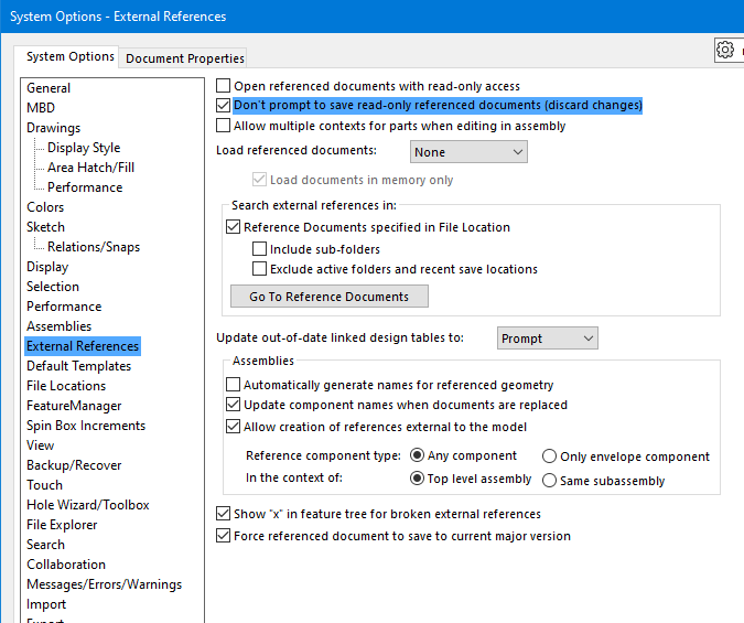

P.S. If you are using this app, I would recommend checking this box in SW Options so it doesn’t bug you about re-saving Released docs. This macro app already saves them automatically just before setting them to read-only.
