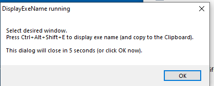

To get this executable name, run “DisplayExeName.exe”, make Visualize active and press the keyboard shortcut for “DisplayExeName.exe”.(Ctrl+Alt+Shift+E, shown on “DisplayExeName.exe” startup).
Once you have the executable name (and pasted it into “Reverse Mouse Wheel V3.txt”), you don’t need “DisplayExeName.exe” anymore.
