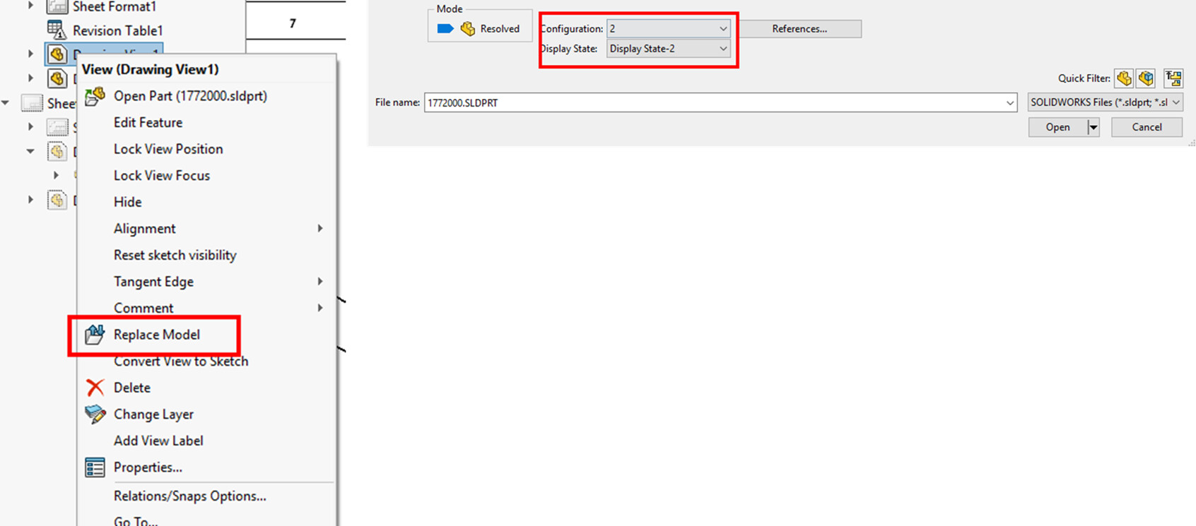

Option 2: Using Replace Model with a intermediate dummy part
Replace Model allows you to change the model and configuration at the same time for all the drawing view.
https://help.solidworks.com/2021/english/SolidWorks/sldworks/c_Swap_References_Tool_for_Drawing_Views.htm
However, it will not work if the file name/reference is the same. The workaround will be using an intermediate dummy part.
To do that:
- Select Replace Model
- Select All view
- Browse and select the intermediate dummy part (eg: Dummy.prt)
- Select Replace Model again
- Select All view
- Browse and select your original file, select the configuration in the open window

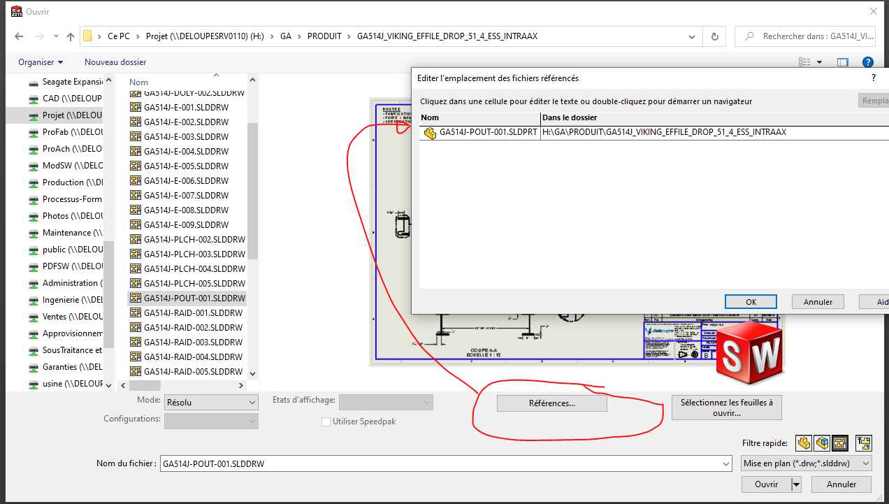

You can change the file that is used in a drawing using File>Open>References

I don’t think you can pick the configuration when using File>Open>References
It works great for swapping one part or assembly with another and not having to do the drawing from scratch, especially on parts where you do a save as and make it a new version of a similar part.

And so, if I understand your meaning correctly, save my multi-body part with the same name but in the new configuration. Then close the part.
Now use the open file dialog to select the drawing file, (and yes, as was stated by TTevolve, you cannot select the configuration of the part to open),
When selecting the referenced part to open, I selected the same part, in the hope that the SW would indeed assume to load the most recently saved configuration into the drawing file.. But Alas, it is not to be.
I also tried to save the part with a new filename and then open the drawing file by referencing the newly named component..
Indeed it did open the newly named part. But retained the configuration that the views (and cut-list) were previously associated with.
In fact, I tried opening the newly named part with all other configurations deleted. Something in the way SW retains references meant it stubbornly refused to accept the file I stipulated and opened the original file with the unwanted config anyway.
The only success I did have, was to rename the original folder, delete all other configs within my copied file (of the original name) and then the refences process of the drawing file open did yield success. The original config could not be found and so the SW opened the file with the only config it could find.
