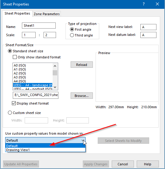

Here’s how I did it in one of my add-ins. The “Default” view is the first view that’s dropped on the first sheet unless otherwise specified. If it is named anything else, this will loop until it finds the correctly named view

The default means you want the default behavior:
from the help files for the sheet:
Use custom property values from model shown in
If more than one model is shown on the sheet and the drawing contains notes that are linked to custom properties of a model, select the view that contains the model whose properties you want to use. If you do not specify otherwise, the properties of the model in the first view inserted into the sheet are used. Or, select Same as sheet specified in Document Properties if Use custom property values from this sheet on all sheets is selected on the Drawing Sheets document property.
