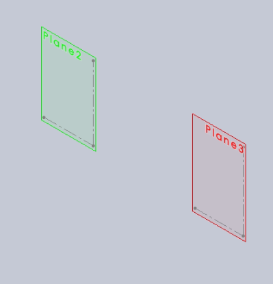

One more trick for you :
Define a plane by the means of 3 points. This way you have full control of which side of the plane is ‘normal’.
Depending on if you select the 3 point CW or CCW will namely determine what side of the plan is facing you or away from you.
I find it particular useful on planes that might have a rotation change (vessel design).
I never tried the 3-point method. That’s a new one to me.
Observing and controlling reference entity polarity is something that took me a while to understand (with other’s forum help), and has been greatly helpful once I did.
I’d just like to point out the two differences in the images shown. (Thanks Peter for a clear illustration) They are different colors indicating opposite orientation, but that can be altered with system options. The difference which cannot be altered is that the one facing you has its name left-justified to the top corner, and the one facing away from you has its name right-justified to the top corner.
