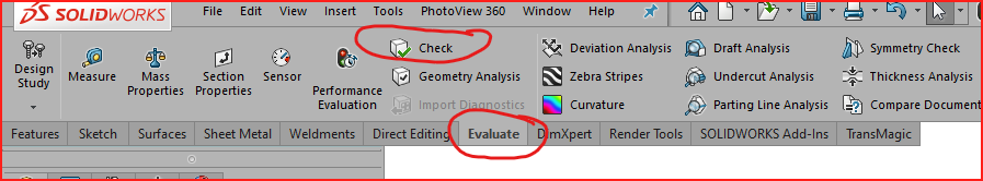

Before you shell, go to evaluate–> Check

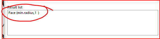

Check the “Stringent Solid/surface check” and then make sure that “Minimum Radius of curvature” is checked.
If you get any surface errors, then they may be your culprit. You will probably need to fix those before you can move on.
Also, it will give you your minimum radius. Your Shell operation cannot be thicker than whatever radius is shown.
