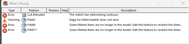

Additionally, you can access the “What’s Wrong” dialog information by using IModelDocExtension.GetWhatsWrong(). It will output an array of problematic features, and array of error codes, and an array of warnings.
https://help.solidworks.com/2023/english/api/sldworksapi/SolidWorks.Interop.sldworks~SolidWorks.Interop.sldworks.IModelDocExtension~GetWhatsWrong.html
I have this running in one of my apps to check for rebuild errors.
Compared to the SW window:
